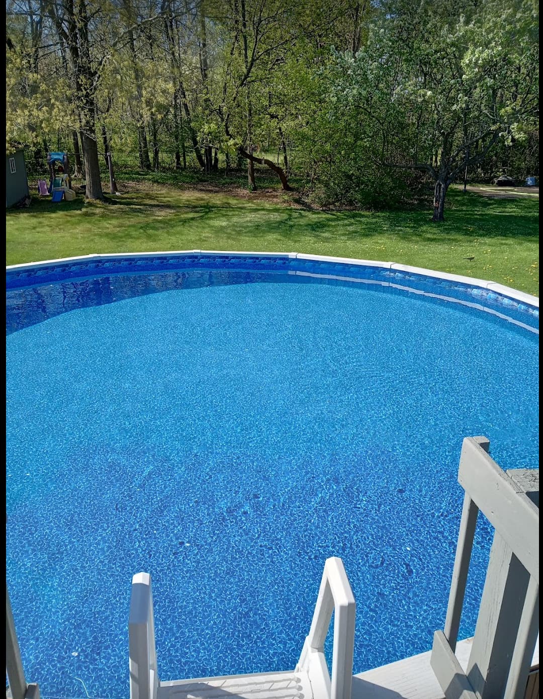

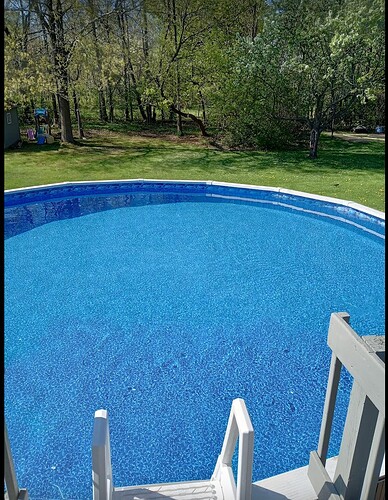

We are up and running!!! 58 degrees though…Chlorine is up…I only got it up to 4 this evening…will do liquid CYA tomorrow morning…will do a gallon and see where it’s at…
liquid CYA Added…shaked it hard…some granules fell to the bottom, but then i just swished them around with a brush…i think we’re good with that…looking brand new…
Thanks for everything!!! Just missing about 20 degrees! :slight_smile:

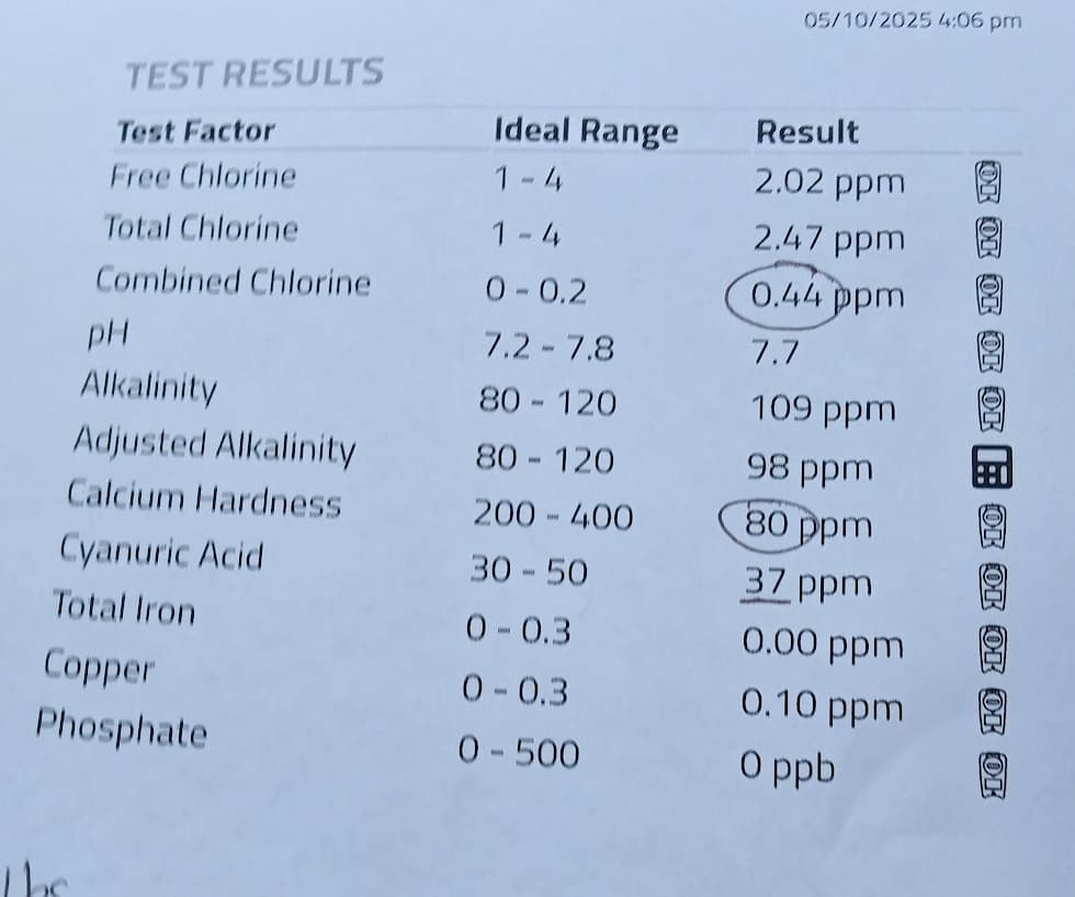

CC was slowly creeping up…expecting cool temps and some rain…super chlorinated up to 10ppm, hopefully, it will rectify the situation (CC was .41 then .66 something when i retested for calcium hardness)…CH is now 122, I’m okay with that…not entirely sure if it even needed to go from 82 to 122, but im content now…

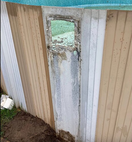

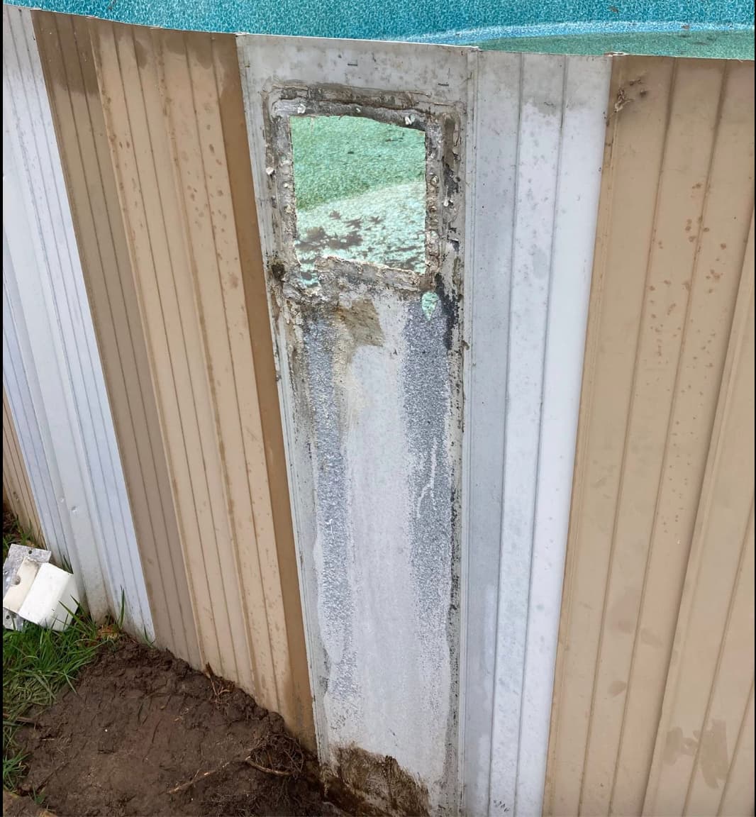

I can’t believe how bad that skimmer slat was…
