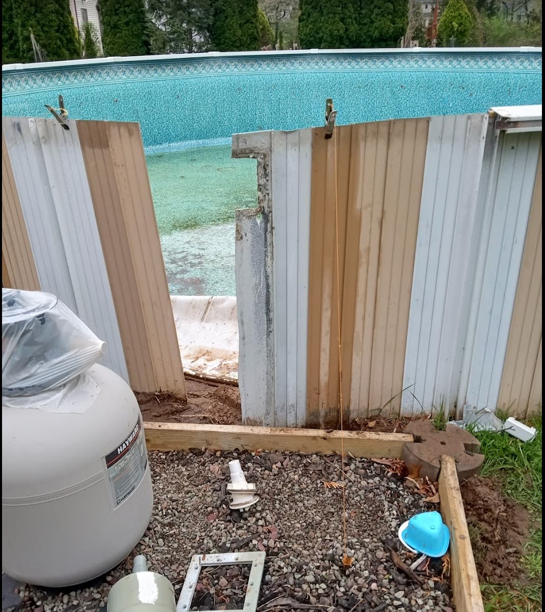

The process has begun…

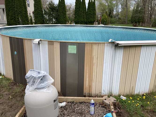

Phase two — Replace air intake slat — Went as well as possible
Phase three — keep your fingers crossed, they were at it for a very long time today…coming back tomorrow to hopefully figure out how to get it out…
![Screenshot 2025-05-04 at 7.08.23 PM|445x500]
(upload://sHalV6oZqrkp6wuhm5FZ5dbDOzs.jpeg)
Looking good! Those slats are very difficult to remove and replace after sitting there for so many years.
Thanks for the update!

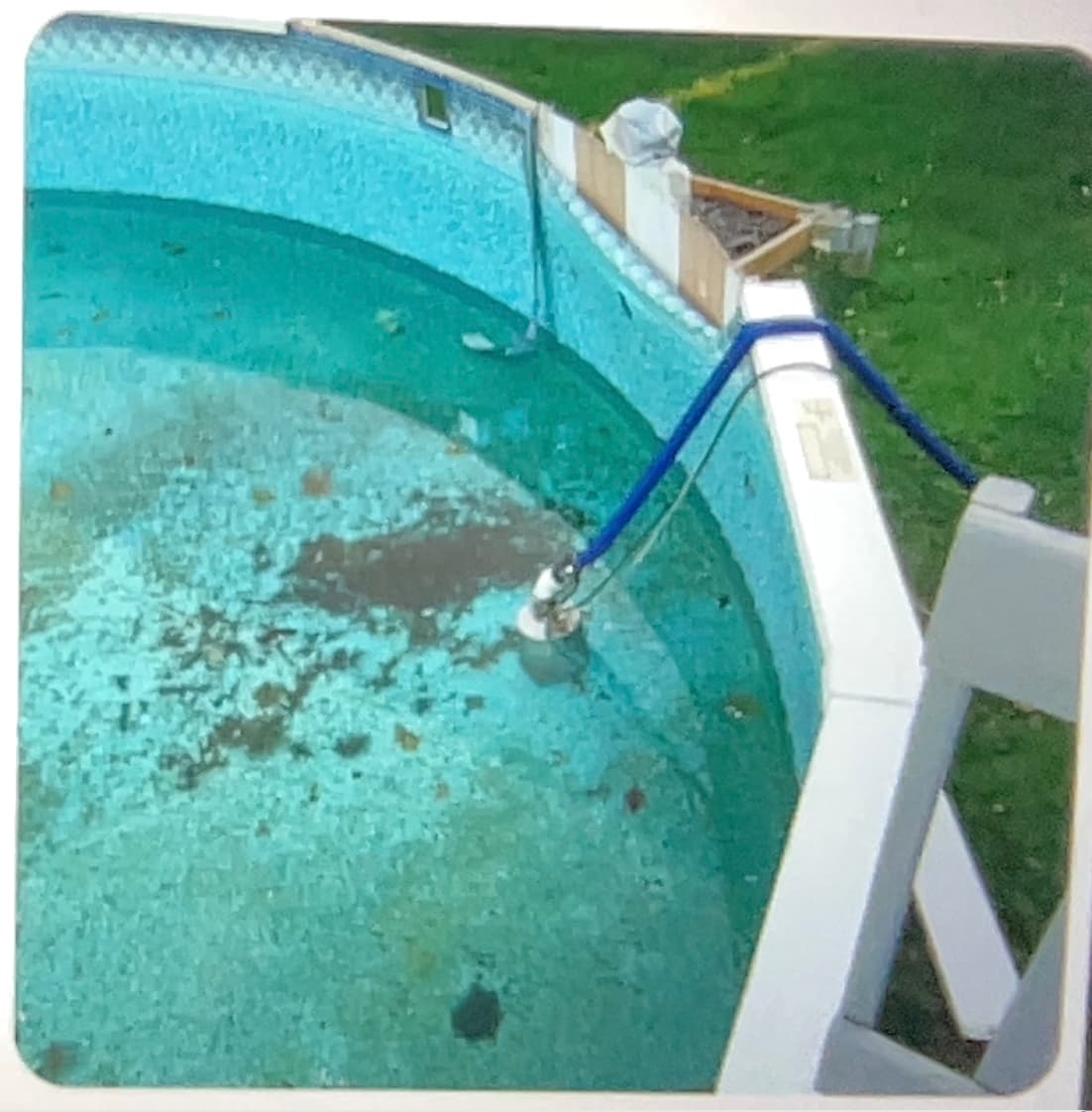

Some people think
The Sistine Chapel in Rome or The Great Pyramids in Egypt or the Mona Lisa in Louvre are an amazing sight to see that every person should experience…
However, I believe this may take the cake…

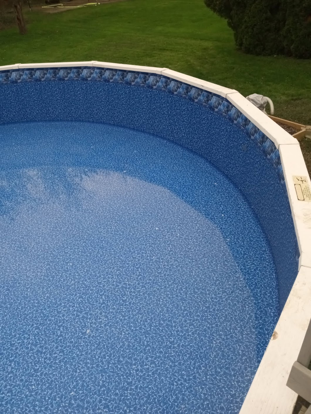

Phase Four liner…SUCCESS!!!
Phase 5: Install new skimmer basket + reconnect pump/filter coming soon!!!
Phase 6: Balance the chemicals
Phase 7: JUMP IN !!!
We’re getting there RICH!!!
Wow! That is looking great!!!

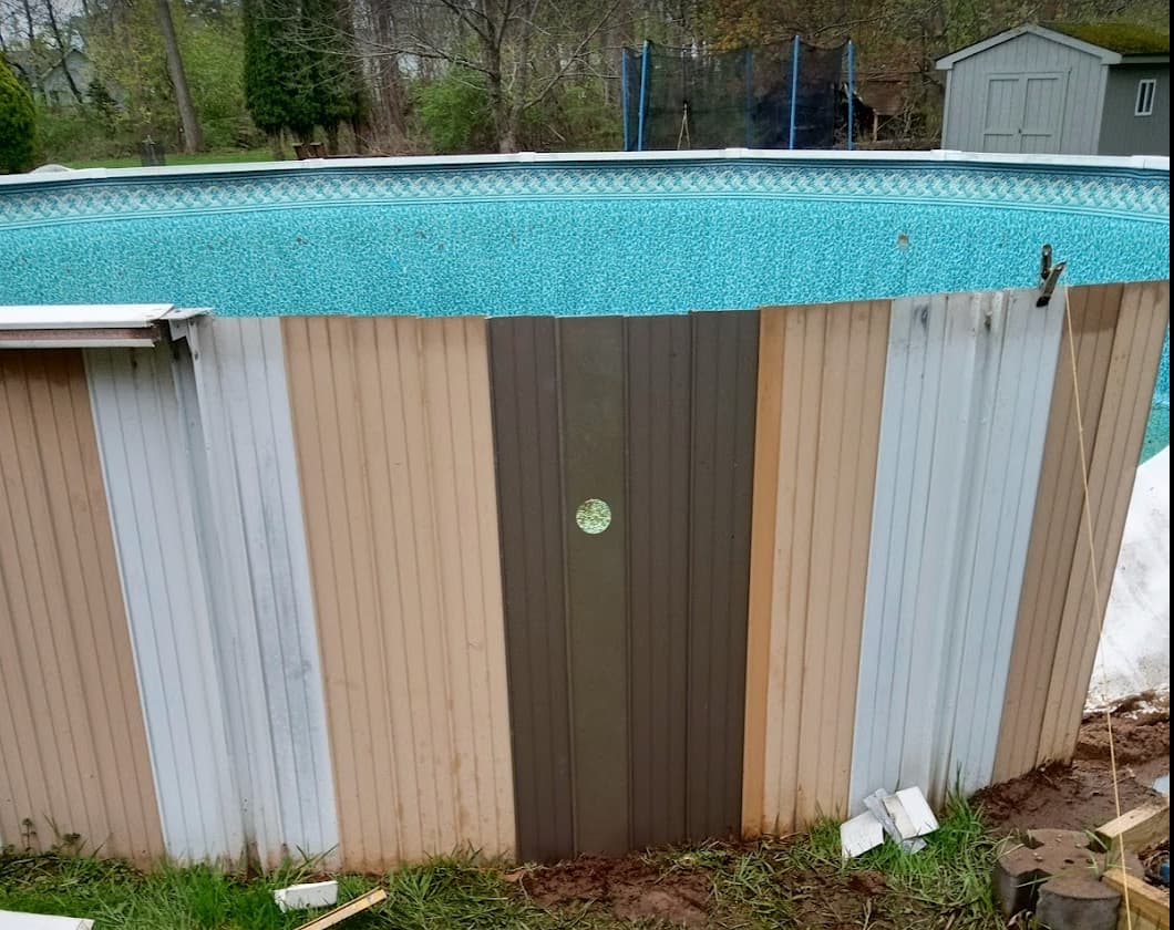

I was nervous…he struggled for hours with the skimmer slat. He asked if he could cut it, but said if he cuts it, things can go south real quick. He chiseled each side of it out, and used the extra slats to help. It came out beautifully!!!

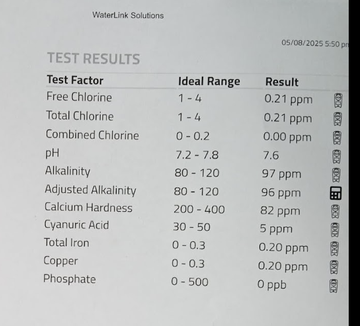

Chlorine is 5.50 a gallon at Walmart, around the corner, always in stock…be interesting what pH and alkalinity is without adding any chemicals (what hose water is)…
I keep CYA at 35 - 40 only because wife likes the chlorine level low, even though shes never in the pool. Our youngest has some sensitive skin, but we were perfectly fine last summer, kept it at around 4-7ppm with no problems…I get it up to 7 and change at night time and its get down to 2-4 depending how hot it was that day!

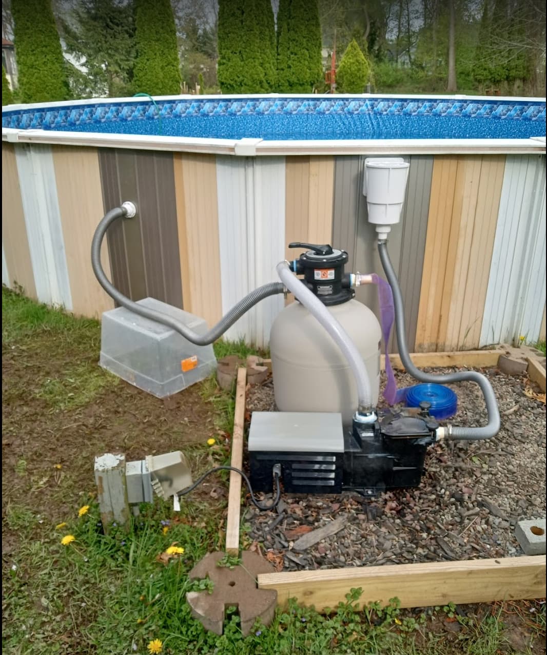

Phase 5 is complete!!!
Onto operation RISE WATER RISE!!!
Didn’t look like he used plumber’s tape for the connections of the hoses…thoughts on that??? Obviously, will find out once the pump is turned on…
That’s a good thing, as most unions and pool fittings have an o-ring for sealing. There are very few locations on pool fittings where you need anything like teflon tape. It sounds like you had a good pool tech putting everything together!

So it seems like I do have to fill the pump up with hose water…once that’s filled…close it up…turn sand filter to “FILTER” and then just turn pump on? Is it that simple?
You probably don’t need to do that. Above-ground pumps are (generally) lower than the water level of the pool, so they fill up quickly. Check your multiport valve to be sure it is open and away you should go.
