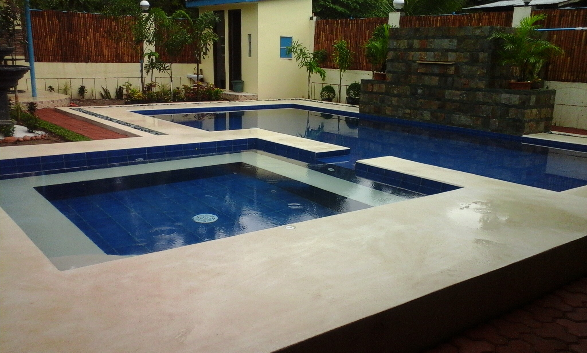

but sir, our pool have no skimmer, is there an another way to introduce the DE powder in the Filter tank.?
