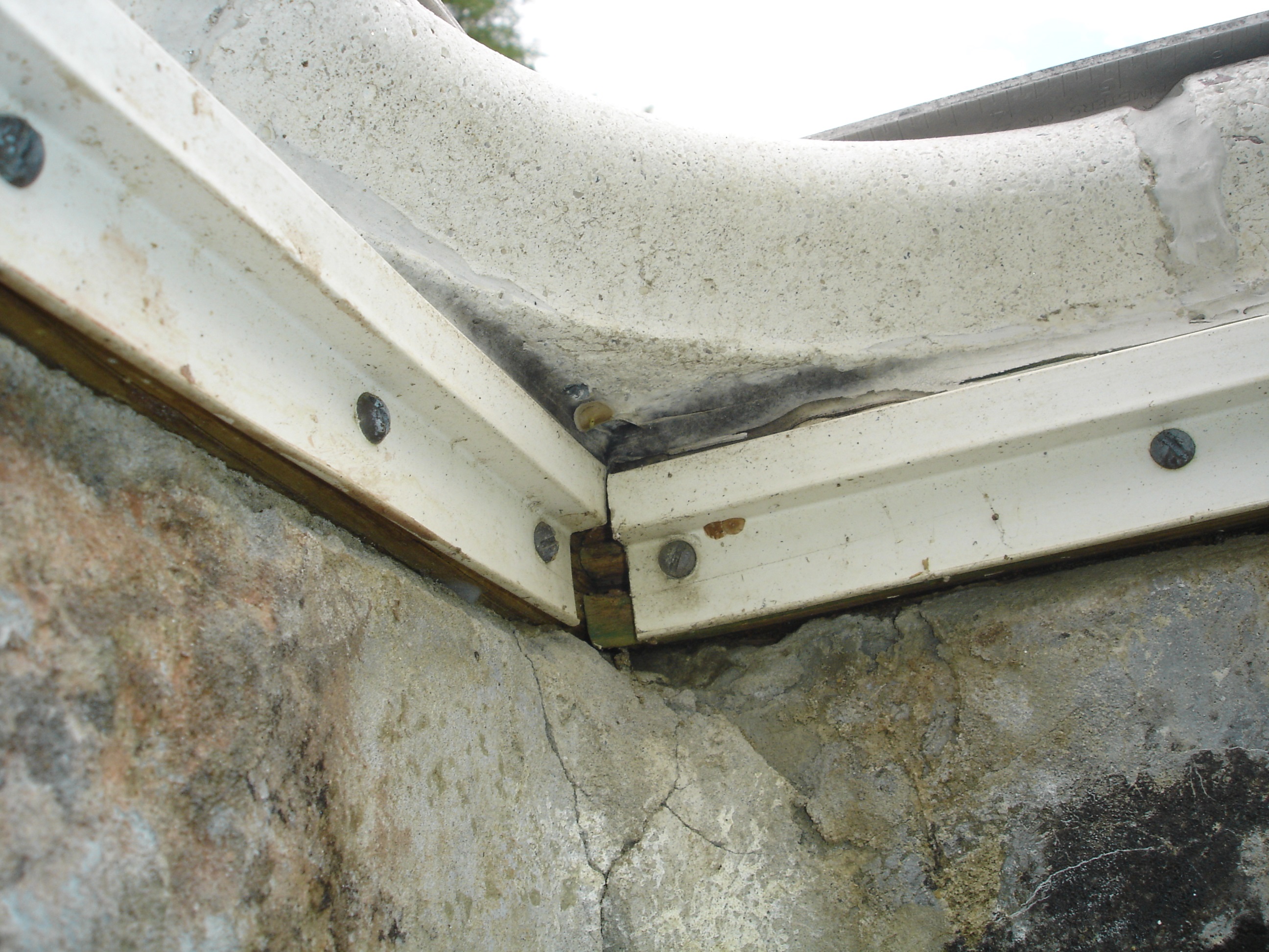

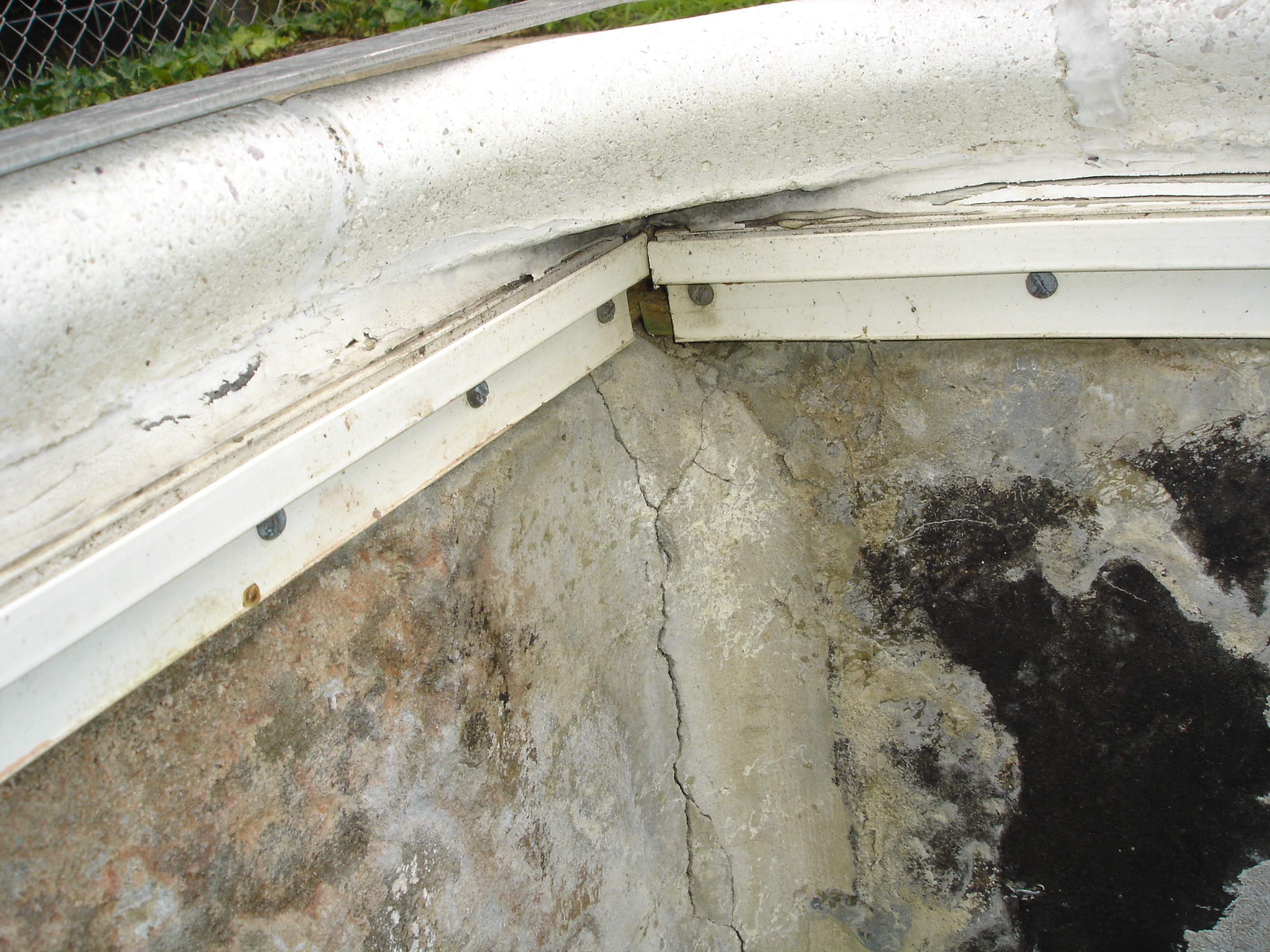

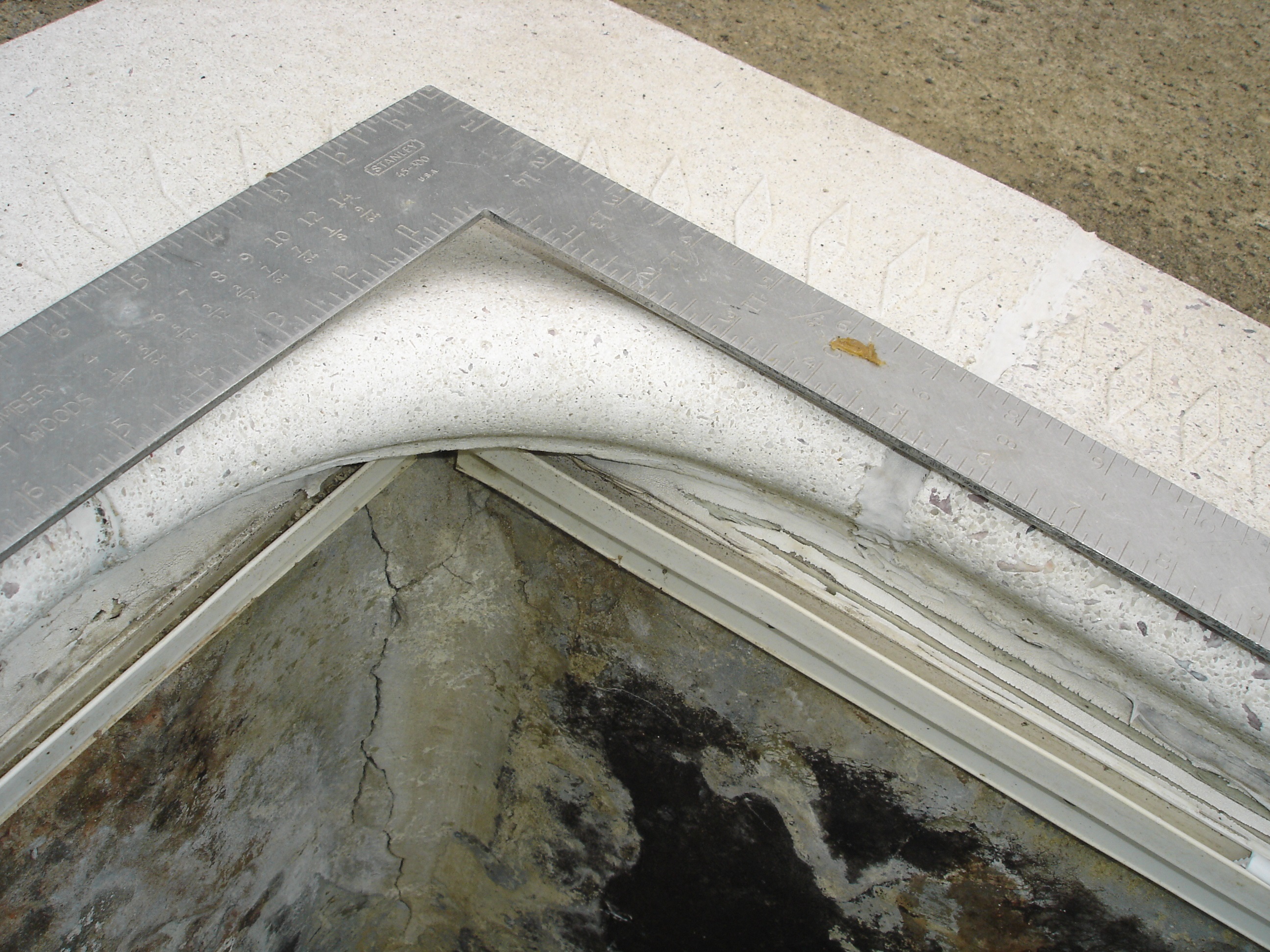

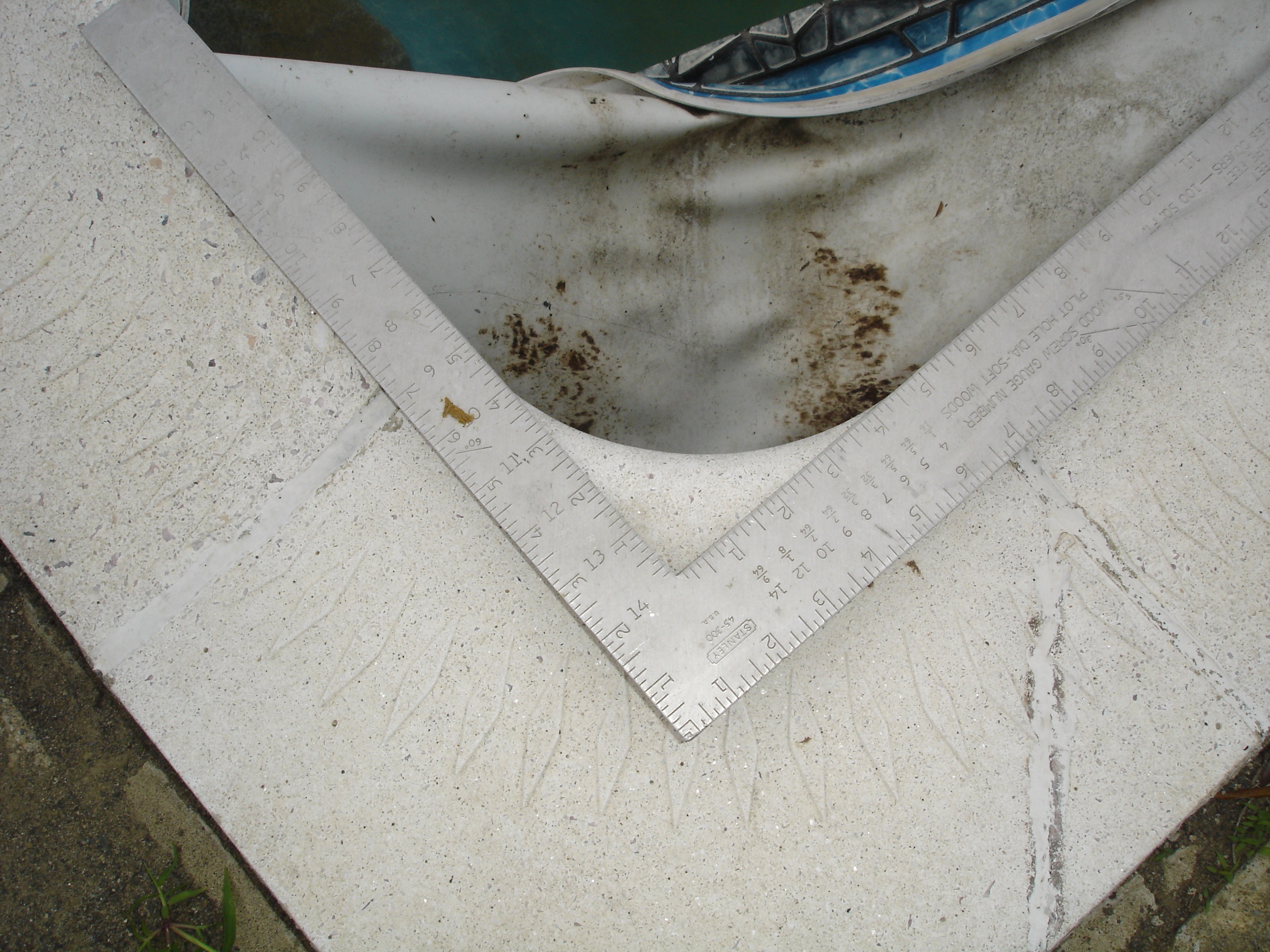

i have an inground pool with vertical extrusion coping to accept theliner bead. I need 4 corner radius pieces with a 3" radius to properly fit the liner.
Please see enclosed pictures…

Patrick,
It appears they have a vertical mount track, like our VM1 or VM3 mounted under a bull nose paver. With our VM1 or VM3 the smallest radius bendable is a 6”. The way their bull nose paver extends out over the edge that may hide any gaps etc. Really hard to say.
I’m not aware of any extrusion where a 3” radius is attainable without jeopardizing the liner track.
If the homeowner would like to call me I will be happy to visit with them.
