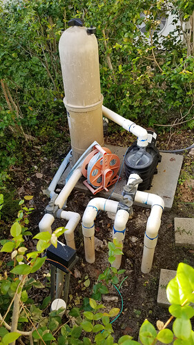

I have a Flotec AT251001-01 1 HP 230V pump that is very loud. I would like to replace it with a variable speed pump. Which one do you recommend?
Also if you look into the piping in the picture below, it is tight to cut the pipe and have any remaining pipe to put the fittings for the pump. Is there any alternative like an adapter that wraps around the existing fitting, instead of the pipe? I would really like to avoid using heat to remove the pipe from the fitting.
Pool is about 18000 gal, 1 drain, 1 skimmer, 1 vacuum, 3 returns, 1 waterfall (3 x 18in wide). I normally have to shut down the returns to have enough pressure for the waterfall. I don’t know the exact measurement, but the pump is fairly close to the pool. I would say probably 20ft from skimmer to pump. Main drain may be like 35ft away from pump. It looks to me like most pipes are 2in, except for the returns line which looks like 1 1/2, I have not measured them.
Thanks,
