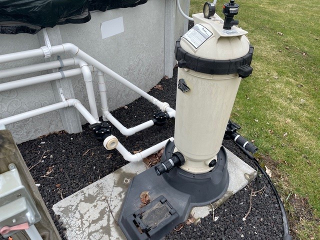

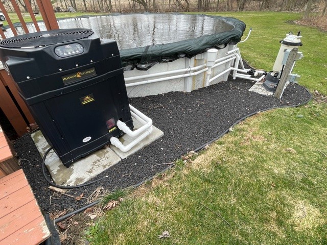

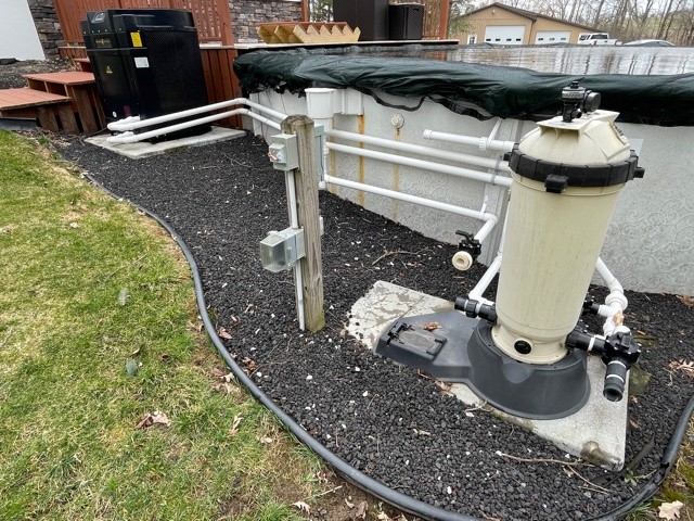

Current Equipment:
  • 24’ Round Above Ground Pool
  • Pentair Clean & Clear CC100 filter
  • Pentair Opti-Flo 1.5HP Pump (340073)
  • Aqua Cal SQ175A Heat Pump
  • 1.5" PVC Plumbing
I have to run the pump on high-speed in order to get enough flow for the heat pump to work which I think is pretty inefficient. Could I use a variable speed pump to save energy or do you have any other thoughts on something that would be better?
