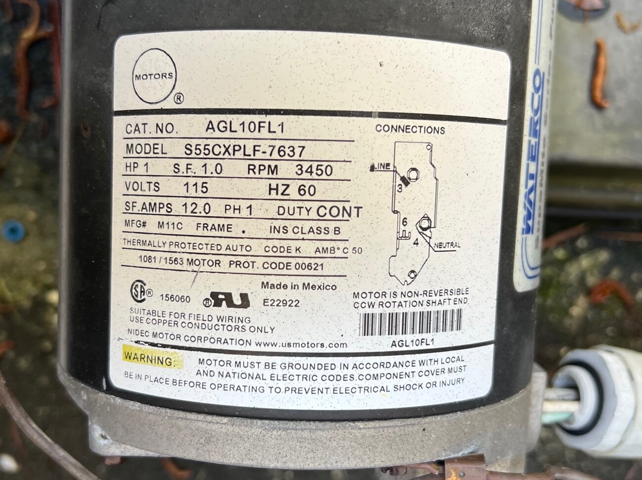

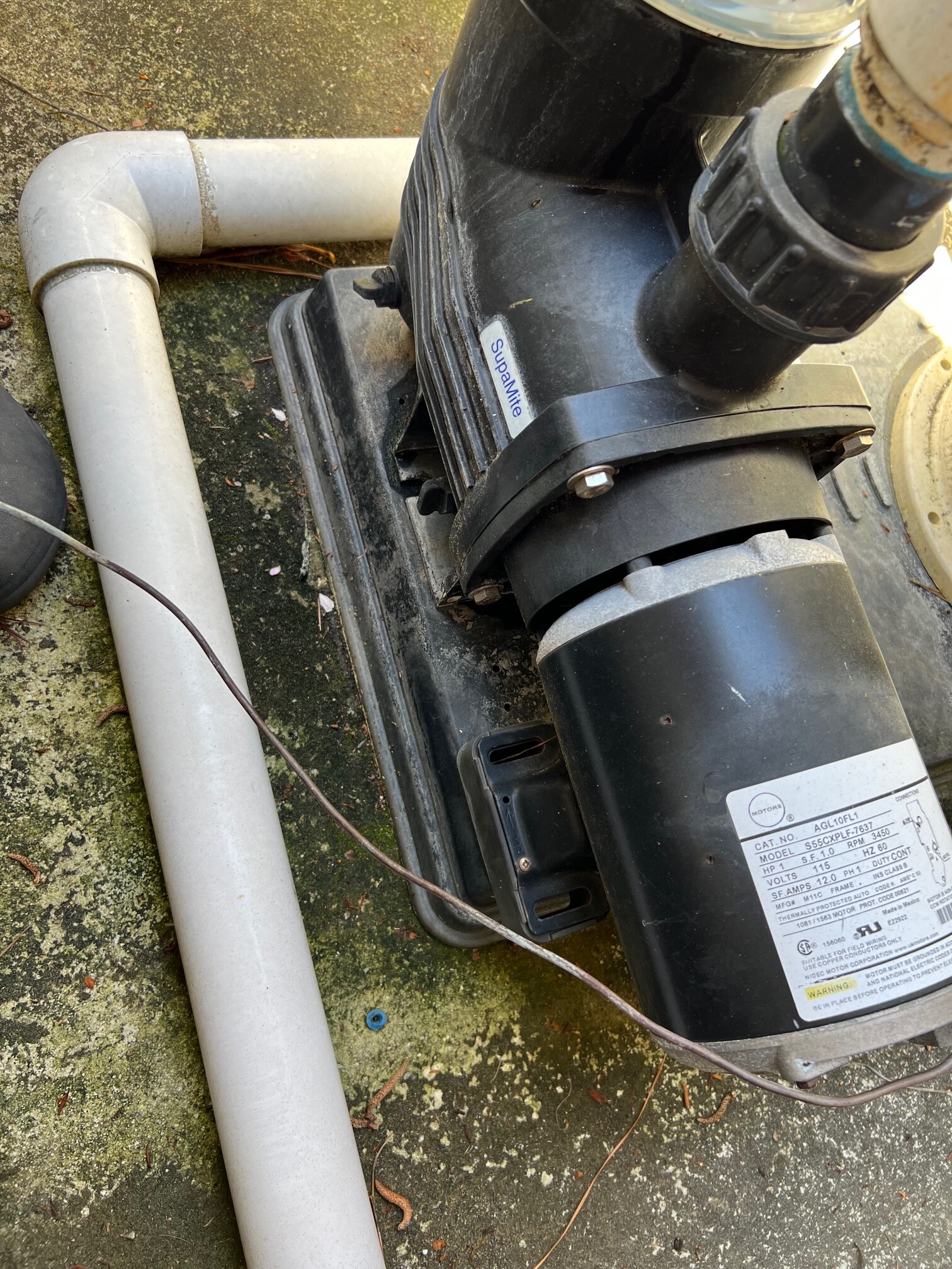

I would like to replace my current singel speed pump motor with a variable speed motor. I would like to replace the motor only so I dont have to redo any plumbing. I have a Waterco supamite pool pump AGL10FL1 model S55CXPLF-7637 (see attached image). Do you carry a variable speed replacement motor that would work? The v-green cross reference guide indicates that ELV08TB would work as the motor has pass through bolts. The current motor is attached to a square adapter plate. Do you think ECM16SQU would also work if I did not use the adapter plate? Thanks, Grant Lane.
Hi Grant, let me reach out to our motor experts on that.  I am not showing a variable-speed replacement for that motor.
Hi Grant, I’ve been told that the Century ELV08TB would indeed be the variable-speed replacement for that, but I am sorry to say that I can’t find it available anywhere.
