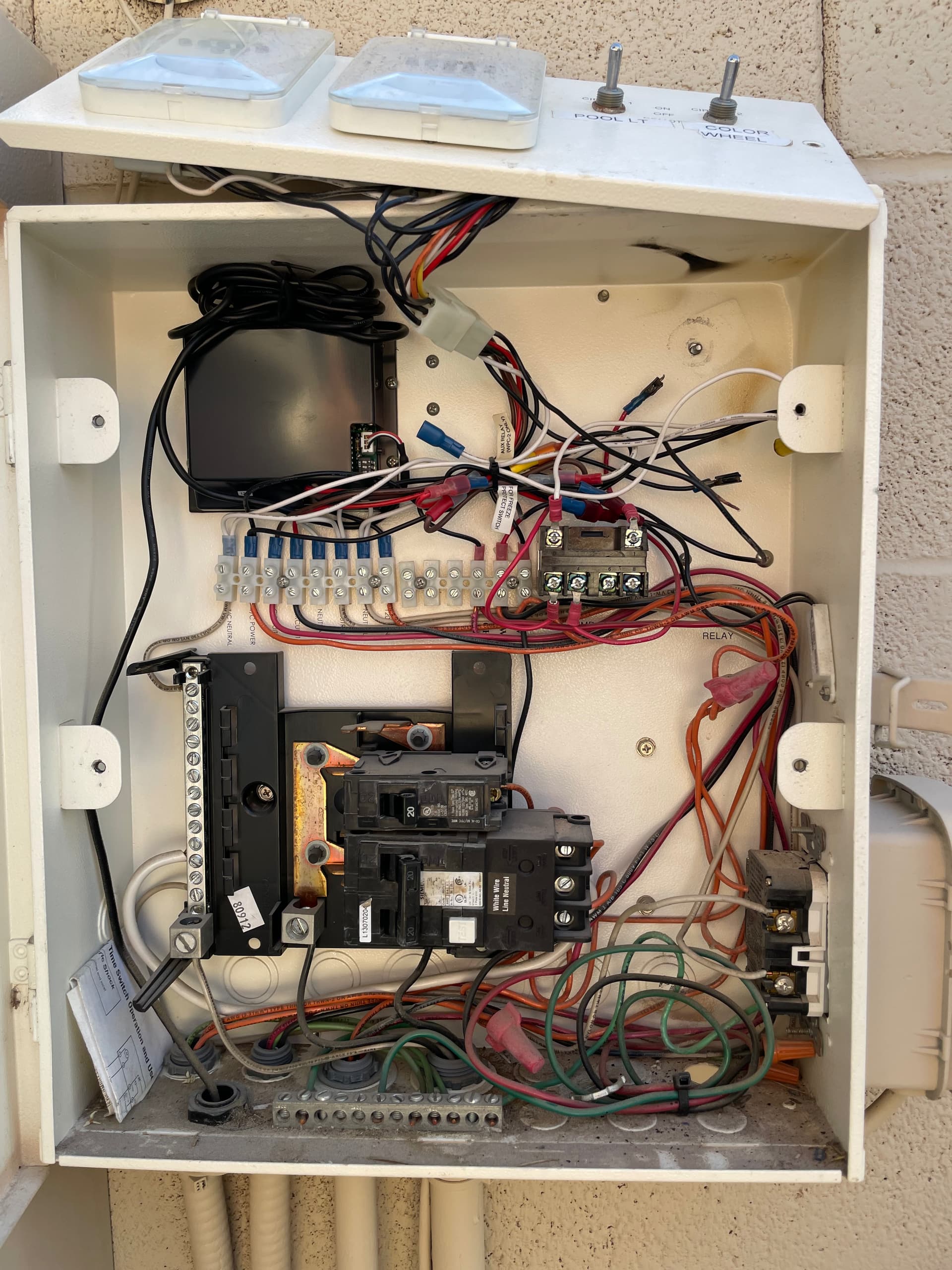

Here’s my panel:
I fixed it. I put in the new relay, the low side needed to go to the NC as it’s normally running all the time and the high speed needs to go to the NO as it will kick on when the timer engages the relay. Because it’s a 2 pole relay they all go on the same side. So that was the issue and it now works perfectly.
