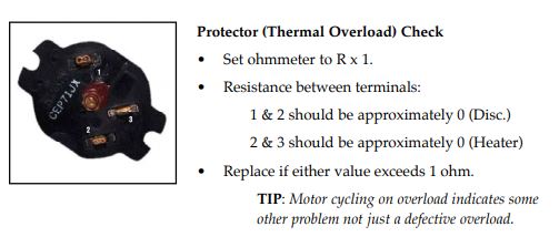

It could be the thermal switch Below are instructions on how to test the thermal overload.
How to test thermal overload switch
Like the tip states, it could be other issues. This could include receiving a voltage that is + or - 10% of the listed voltage. Ambient temperatures around 122° can impact the motor. The more likely scenario is that your motor windings may be failing. In that case, you’d want to replace the motor.
