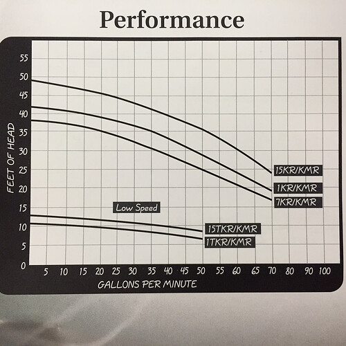

I am an engineer trying to get a DOH permit for an existing pool which has the following pump
Splash Pak K series HP1.0SPL with a 1 HP 3450 RPM pump
I need the performance curve ( flow vs head) for this pump which seems to be no longer made
does anyone have this information
Hi Engineer,
I believe the pump curve below is the information you need for your old Splash Pak K series Pump. The 1 HP would be the 1KR/KMR, I hope this helps.
