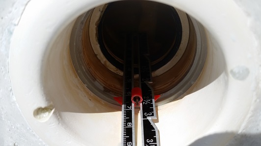

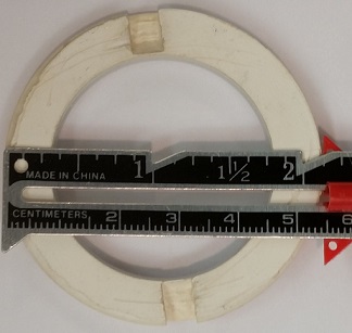

Need your help finding a replacement for my spa jets. We recently bought the house and have managed to replace virtually all of the hardware with your help: variable speed motor, heater, spa blower, pool jet covers, etc. There is a built-in above-ground spa at the head of the pool and the jets are remarkably old/falling apart. We’ve tried several local pool parts houses, but they don’t seem to have the wherewithal to discover a suitable replacement for the originals. I’m hoping you do.
The original part is roughly 3 1/8" long and 1 5/8" in diameter. It is circumnavigated by a ring that is 2 1/8" diameter and 1/4" wide. The ring rests on the head at approximately 1 1/2" depth.
The jet orrifice is 4" deep and the retaining ring for the jet sits at 2 3/8" from the back of the opening. The diameter of the opening is 2 1/4"

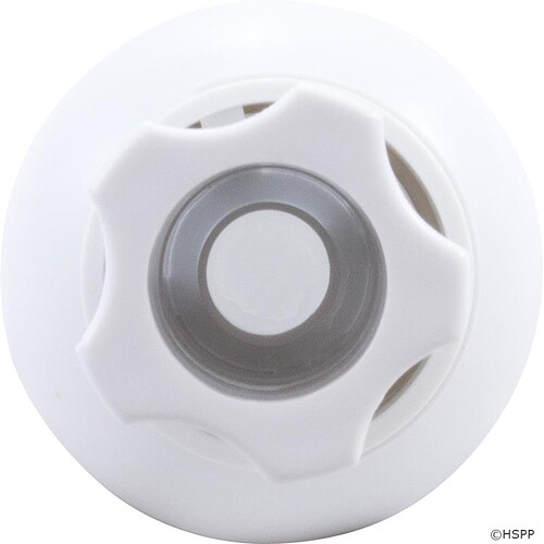

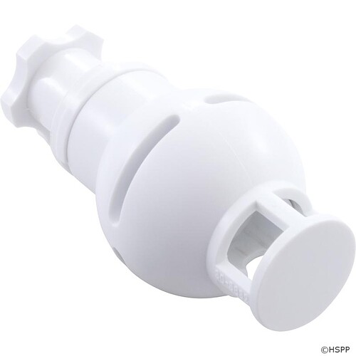

I have been told that there is a replacement for the 9375-08 and I will substitute the replacement on your order. Below are photos of the replacement.
Received the AF Mark II Eyeball Assembly (50-5835) today. It was a perfect match for the spa when paired with the Seating Ring (9375-04) and the Retaining Ring (9375-09).

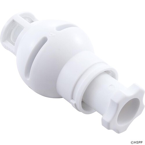

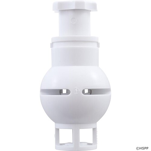

As I will be replacing all the parts, would the Caged Eyeball Assembly (9375-15) replace all three of the other parts in the same fitting?
Thanks for the help.
Hi John,
That’s great news! I’m not 100% sure if the caged eyeball would have all 3 of those parts, I believe that it may be a little different. You may want to order 1 of the caged eyeball assemblies to test if it works, or just stay with the parts that have already confirmed to work.
