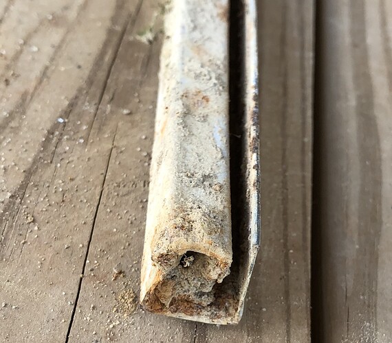

I have a 30 foot round Canter summer Fun above ground pool. The metal bottom rails measured 55 1/2". I need to repace some of these bottom rails because they were rusted when we took the pool down. I am also looking for replacement resin caps. I believe the pool is 10-12 years old. And I also need help in figuring out what size pump I need for this pool. Thanks Tabby

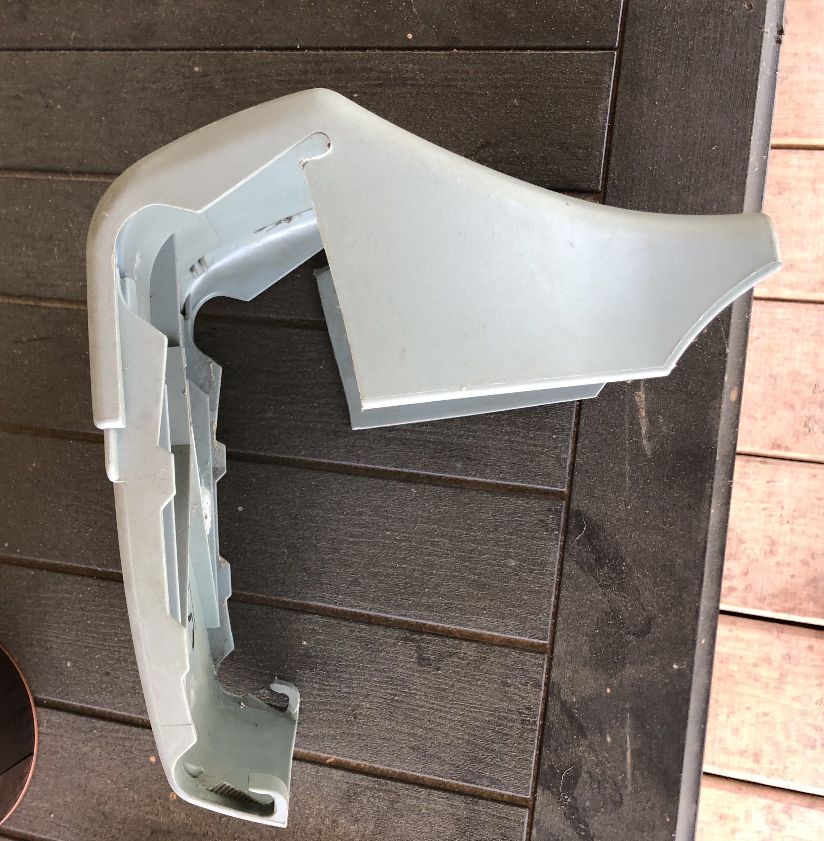

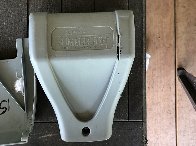

- Top Cap

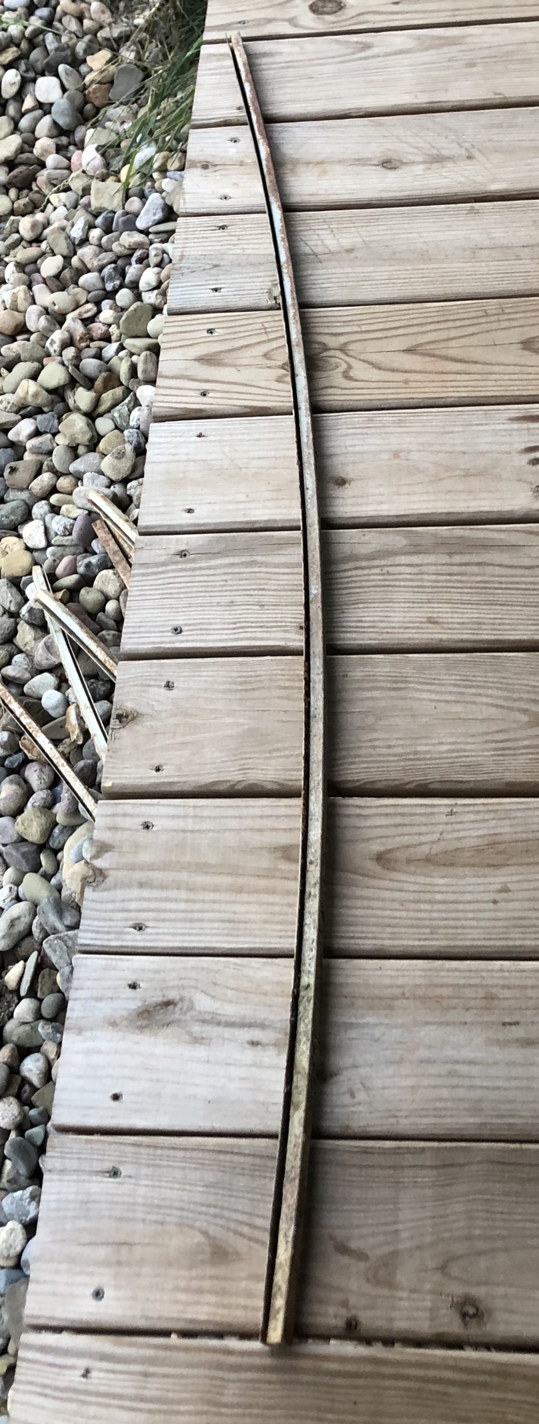

- Bottom Rail (end view)

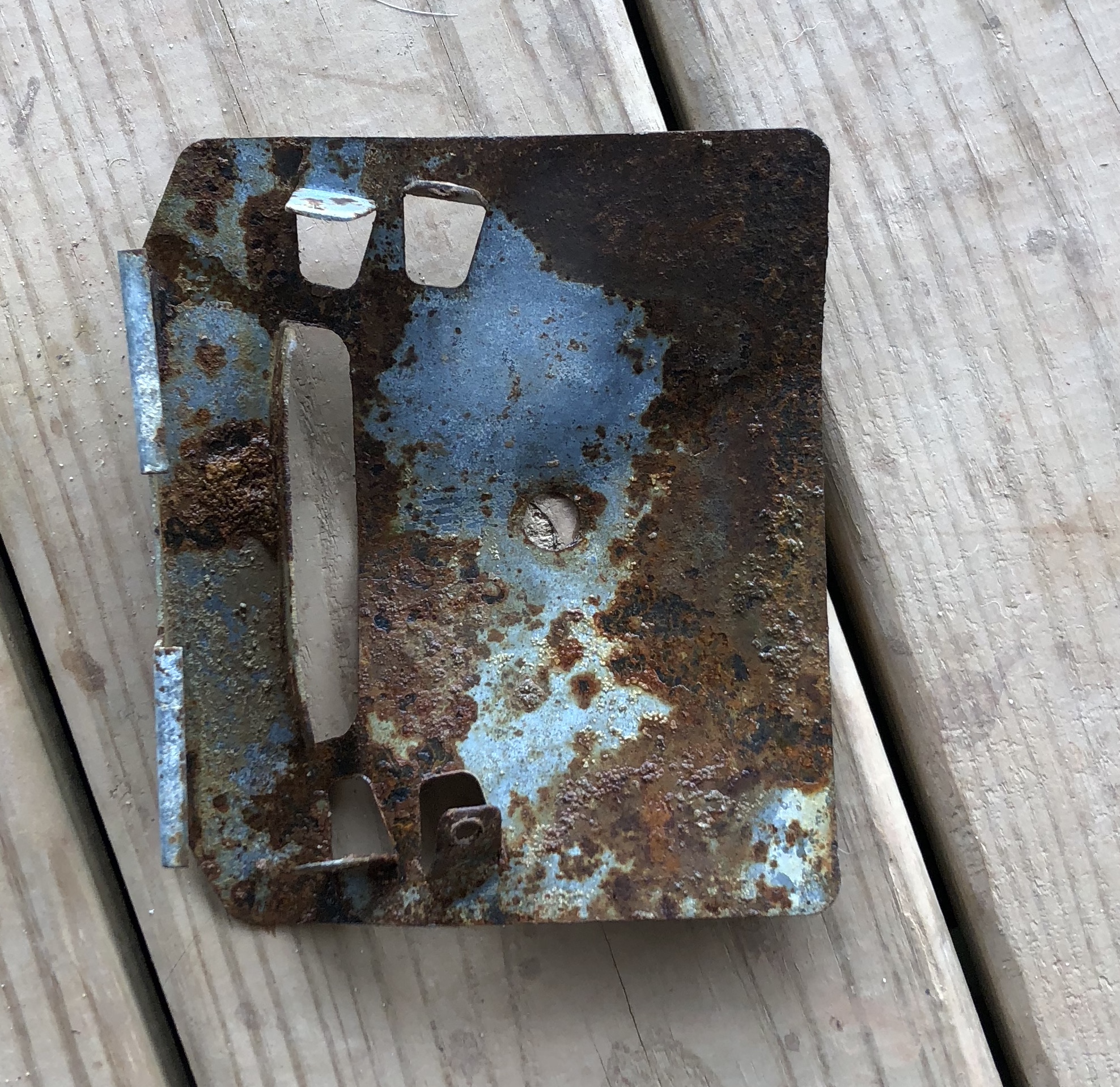

- Bottom Plate

It looks like you have parts for an Estate model. The top cap should be part number 1490592. The inner part for that cap is part number 1490497.
If your pool has a total of 20 bottom rails, the part number is 1255630.

The lady said 30 foot but there are only 18 of each and they measure 55 7/8” long. I took it down but it did not measure it up.
The bottom rail that would require 18 is part number 1460034.
The top cap part number would still be 1490592.

The bottom plate should be part number 1320100.
