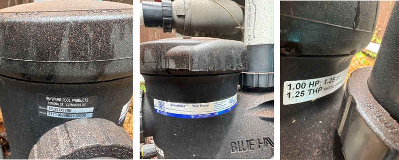

Replacing a Century B2853V1 Pool Pump Motor. Having a difficult time finding the correct seal kit for this. Please help!! Thanks!
That’s because the seal kits (or GoKits) are unique to the pump and not the motor. Let us know what the model/model number of the pump is and we would be happy to help you find just what you need.
Feel free to post some images of the pump and the label on it if you can.
Thank you so much for the response!! See pic below.
Perfect - thank you! That’s a poorly disguised Hayward TriStar/EcoStar pump, so the seal kit is this GOKIT80. They are in stock and ready to ship.
