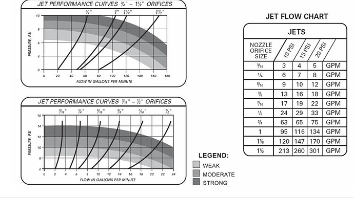

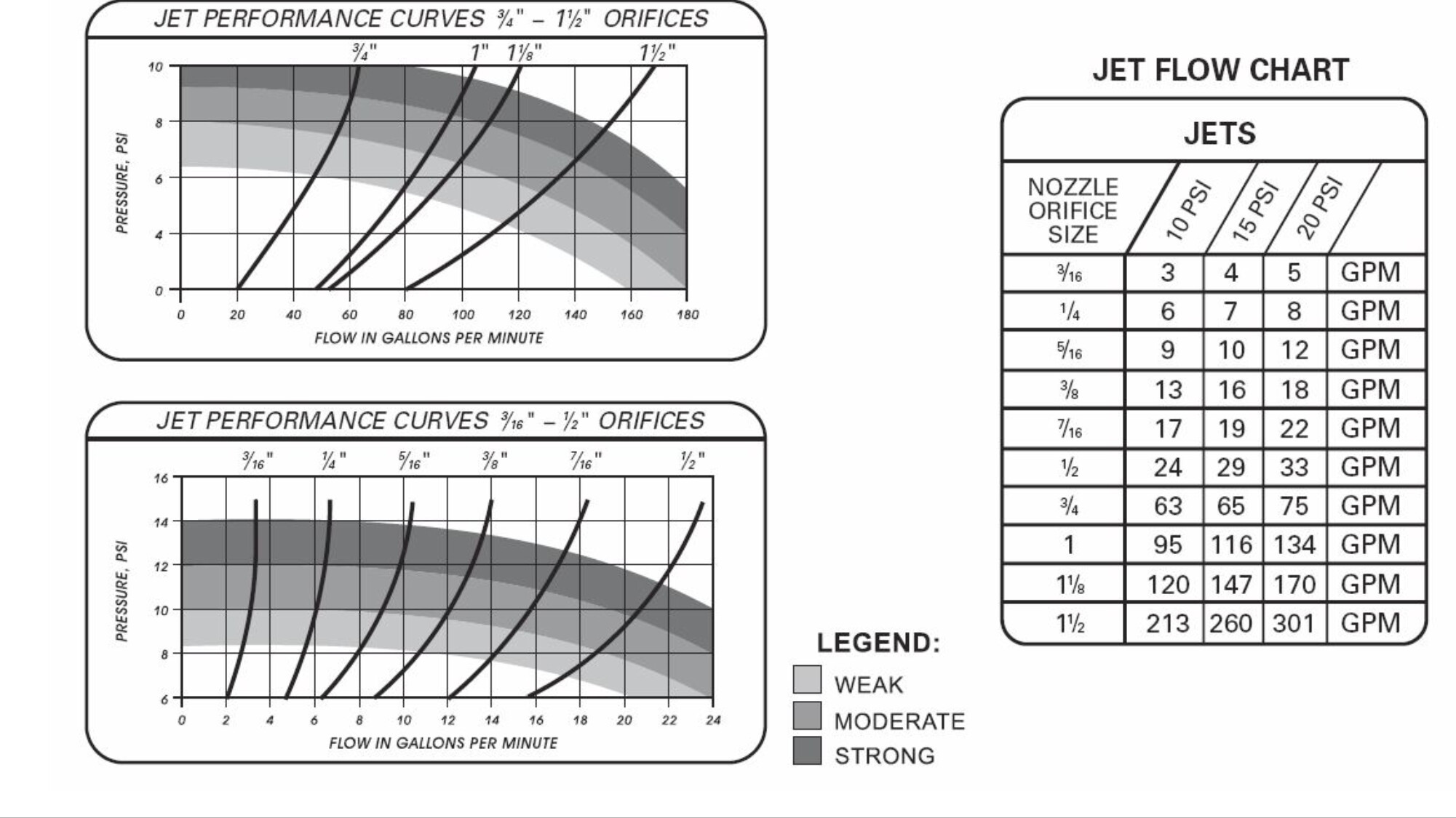

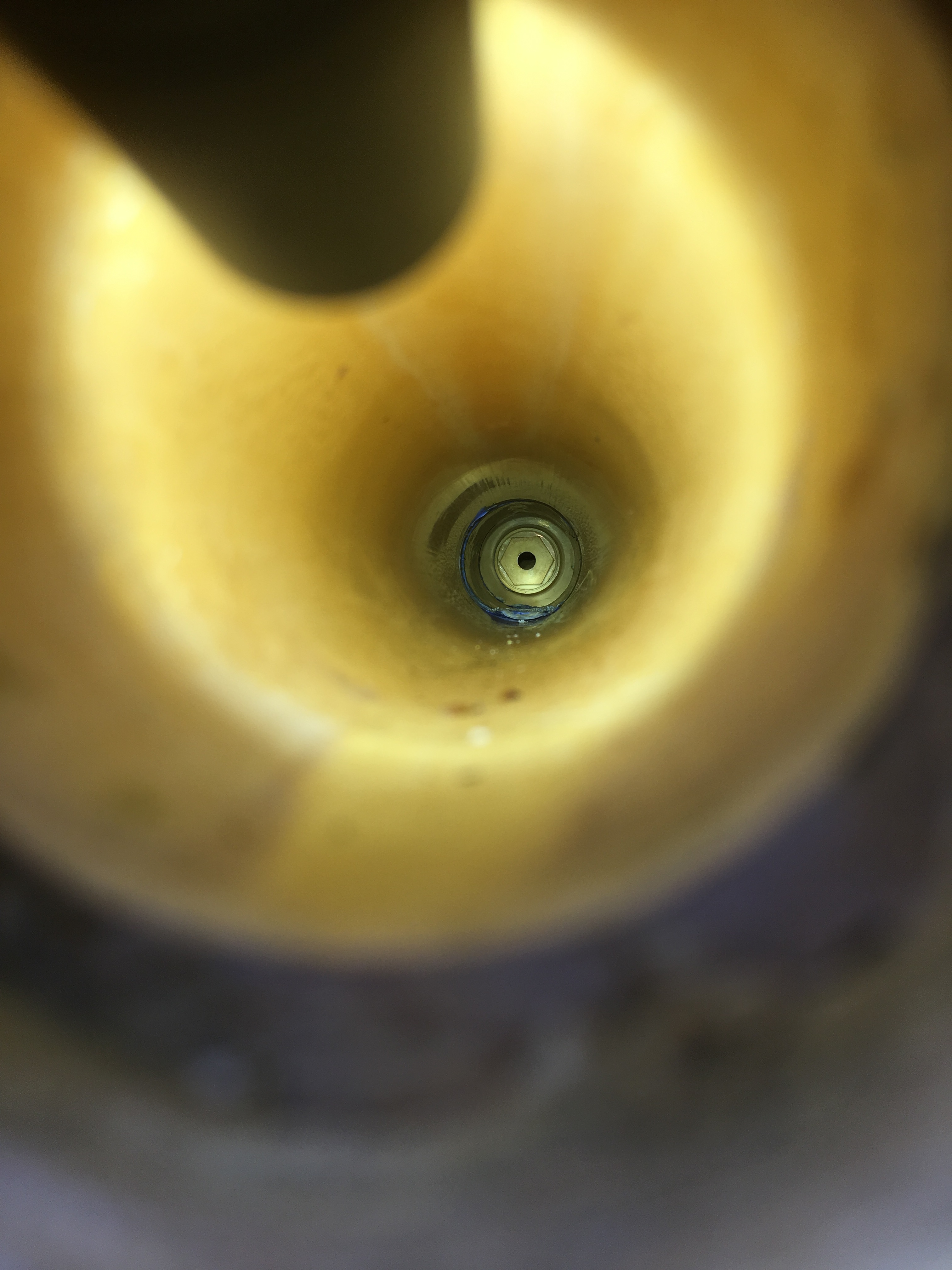

Thanks for the info, I just figured out that my jets are 5/16" orifice which I guess was pretty standard. Pool was built in 84. I found a jet flow chart and jet performance curves online, not sure if this is for a particular brand or if this covers the spectrum. I had great pressure in my spa but I suppose I had a lot of backpressure because I think the pump was oversized. I will post the charts I found and a pic of my jet nozzle. I am not sure I follow the chart…if I require 12 GPM per nozzle that would mean I need only 36gpm at my spa? And what does the 20psi stand for? 20 psi at the discharge of my pump, or is that pressure loss?
Hi ScottyK,
Yes, this would mean that you would need 36 GPM’s for 3 jets if the jets are rated at 12 GPM each. Honestly, I’m not sure how you read the PSI on the chart. I still think going variable speed is the way to go as you can dial the pump into the appropriate speed to run the jets and then dial it down to save money for general pool filtration. The variable speed pump really gives you a lot of flexibility as it can be dialed into any HP from .25 HP all the way up to 1.65 HP or 2.7 HP depending on the model you choose. Based on what you have supplied I would go the 1.65 PureLine Prime Variable Speed Pump.
