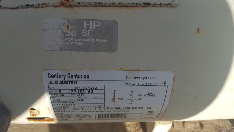

I’m not getting a match on that 8-177425-03 part # Could you take a picture of the motor label and a wider shot showing the complete pump. Once we get the pictures we can definitely make a reccomendation.
From Ray2958
Hi Patrick,
Please find the picture that I have handy… I’ll send you a wide view showing the complete pump today evening once I reach home…

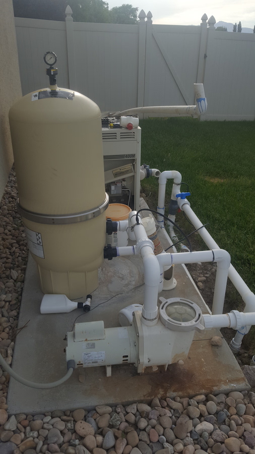

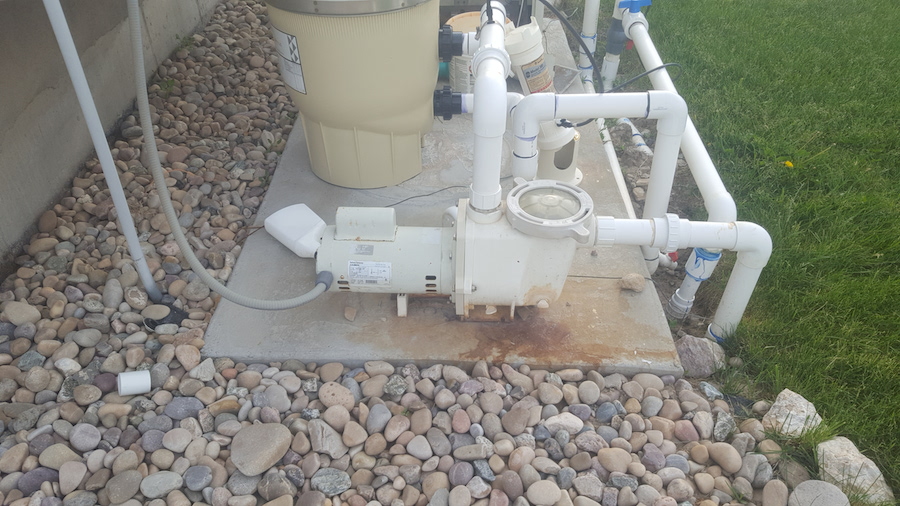

Hey Patrick…
Please find the wide shot of my filter pump attached.
Hi Ray,
If you wanted to stay with the exact same motor then you would go with the B2843 2 HP Replacement Motor You have a Pentair Whisperlo Pump so you would also need a the Pentair Whisperflo Tune Up Kit GoKit32
If you want to go with something really energy efficient then you could with the B2984T Dual Speed 2 HP Motor w/ Digital Controller a dual speed motor has a high speed and a low speed, so you run the pump the majority of the time at the low speed which costs you roughly 60% less to operate then when operating at the high speed. You then can run the motor at the high speed if you get heavy debris or need to vacuum. If you go the dual speed route you would still need the Whisperflo Tune Up Kit. I hope this helps.
