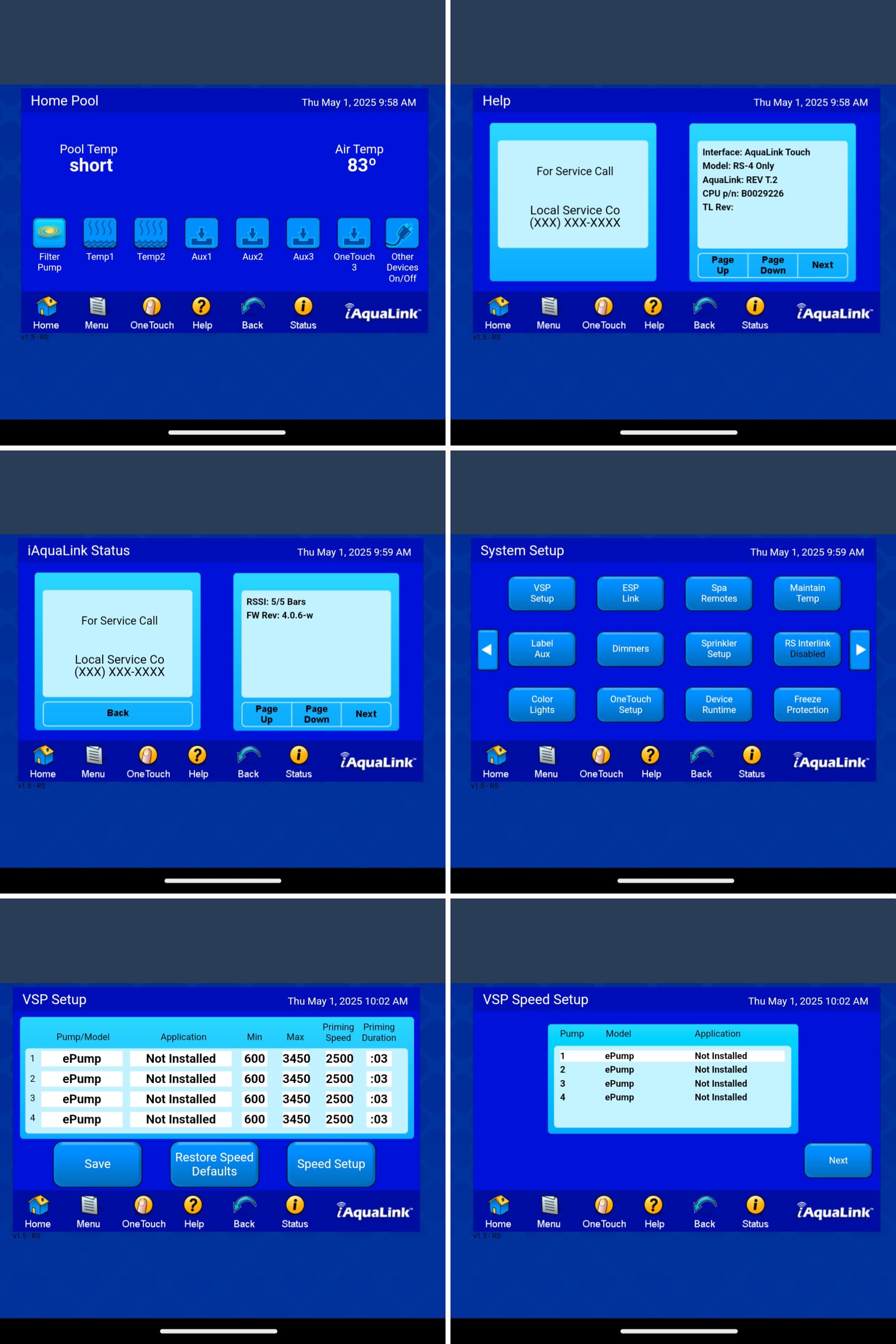

Thank you for your detailed response. Below are the screenshots from my iaqualink webapp and it shows options for setting up variable speed pump. Does that mean that it would support a VSP or is it still tricky? I think if I’m able to identify the firmware version I can deduce from the Jandy manual but not sure if it is version T (from REV T.2 text in we portal) or version W (from FW rev- 4.0.6-w from portal).
If I’m able to control the speed using app, I can go ahead with buying the backplate and diffuser to upgrade both the pump and housing together. However if I’m not able to control the speed, I might need to go with the old housing (with 1 HP impeller) as I don’t want the pipes, filter etc to get damaged due to me not being able to reduce the flow via app.

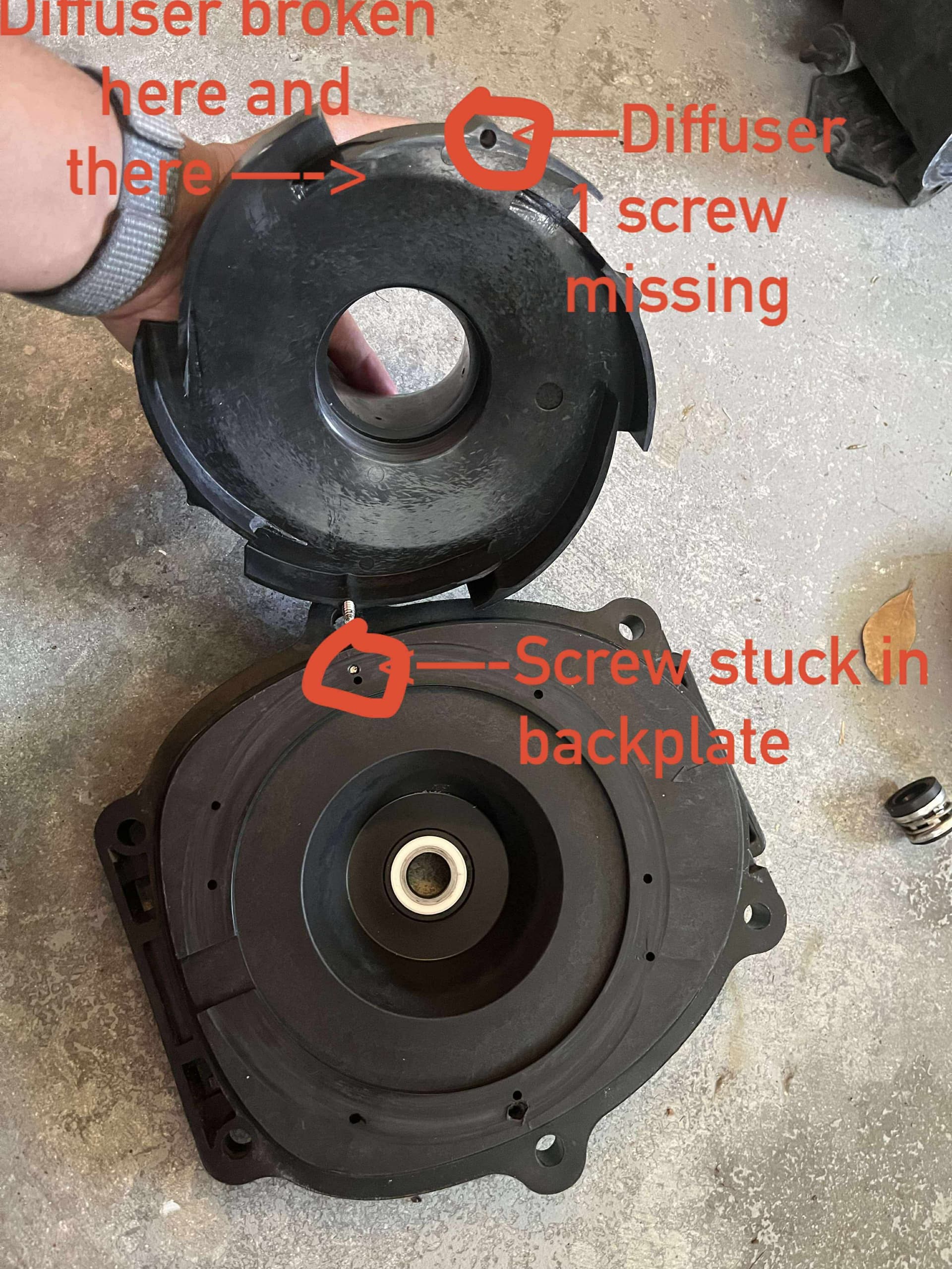

Also, this is what the problem with the current diffuser and backplate is… Trying to remove the screw by myself but it’s lodged in and I’m not sure I’ll be able to remove without damaging the surrounding area.
It looks like you should be able to control the speed of the motor remotely - Jandy motors play very well with Jandy automation.
Note that the seal plate and impeller from the Jandy pump will not work on your SuperFlo pump, so don’t even worry about the screw and diffuser/seal plate.

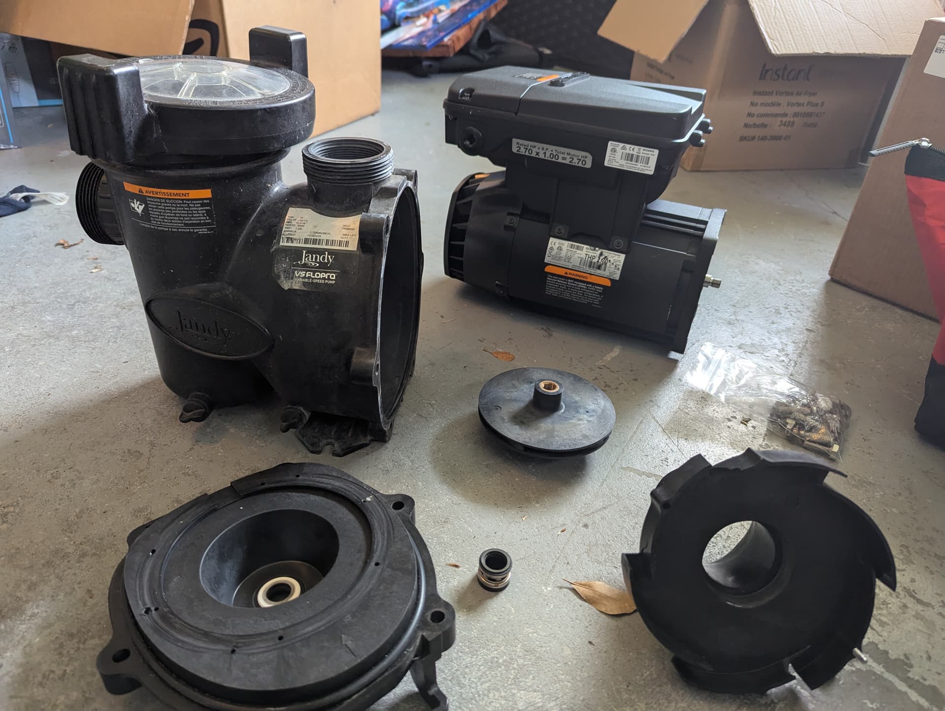

Sorry looks like there is a misunderstanding. I do have a housing suitable for the 2.7 HP Jandy pump too. However the parts within (backplate and diffuser) have the problems as shown above. The decision is between:
Option 1: install the Jandy 2.7 FloPro with my current Superflo 1 HP housing - I need to buy the impeller if I go with this option.
Option 2: install the Jandy 2.7 FloPro with the Jandy 2.7 HP housing - I need to buy the backplate and diffuser if I go with this option
Option 3: Just return the Jandy motor and get a pentair superflo 2.2 HP for lesser cost and install it with my current 1 HP Superflo housing.

Most folks are happy to leave the pump in place and replace the motor/drivetrain and seals; otherwise you will need to move plumbing around which makes the task a little trickier.
All of those options are good with the possible exception of the 2.2HP SuperFlo UNLESS it is also a variable-speed motor (once you have a VS motor you will never go back to a single-speed motor).
Your options are kind-of 6 of one or 1/2 dozen of the other. I would put the Jandy motor on the SuperFlo pump (with the new impeller, seal plate, and diffuser) and call it a day. That is also probably your least-expensive option if you are hiring someone else to install it.
