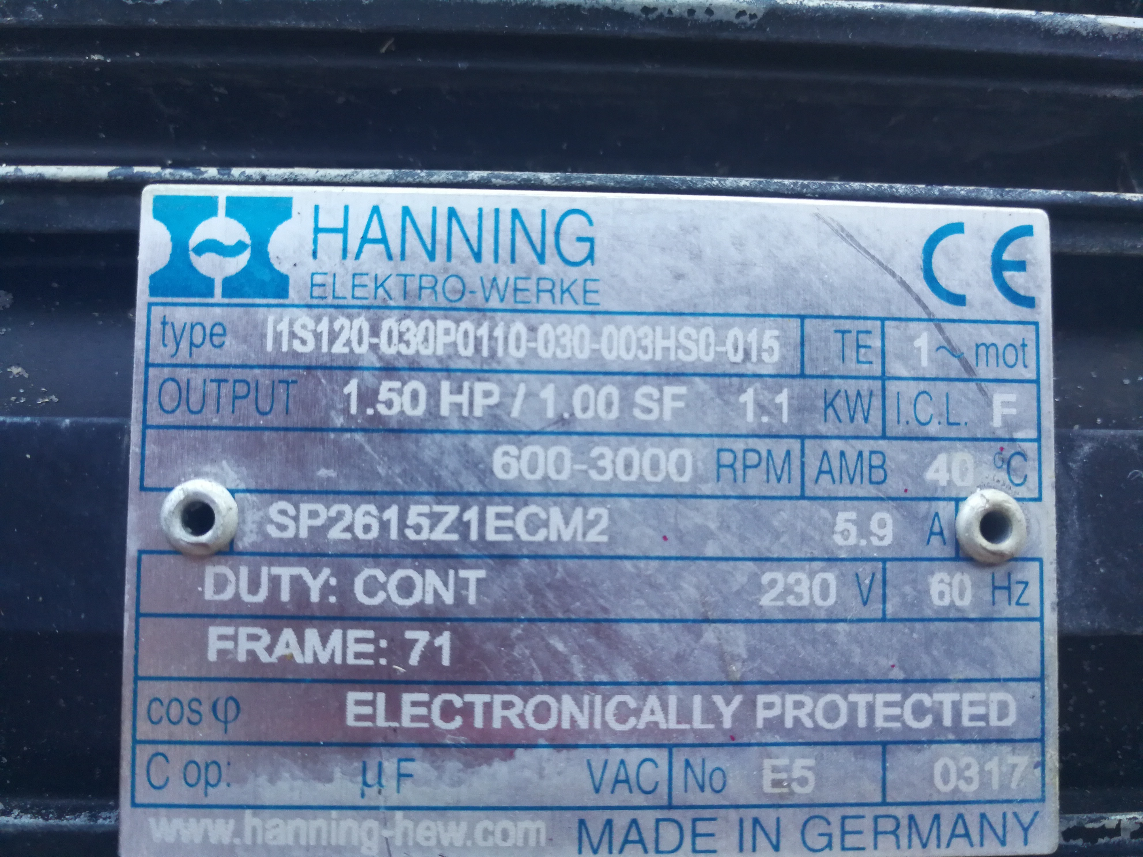

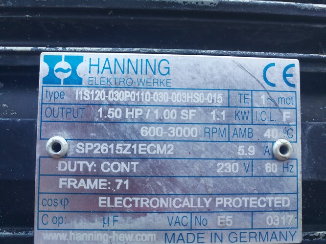

I have the same motor as DavidC18. The motor and the drive is working but I would like to change the bearings, are they available? If not I think if I can get a 2spd replacement motor that would be a good option.
What is availavle?
Hi Malc85, I am sorry to say that we do not carry the bearings for the variable-speed motors like the one pictured above.  The magnets in them are much stronger than a “regular” motor, so replacing them is not recommended by anyone other than a professional motor shop.
Our video on Can I replace bearings on a variable speed pump motor? explains it in more detail.
