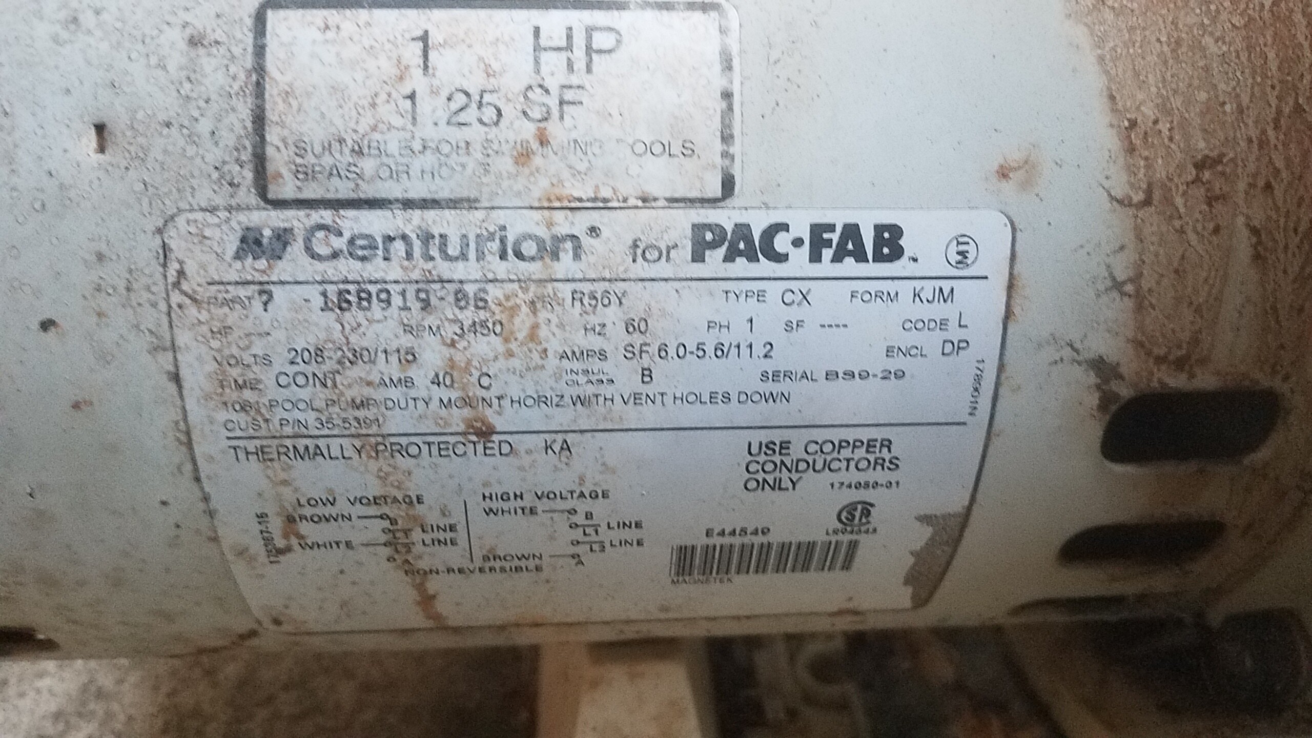

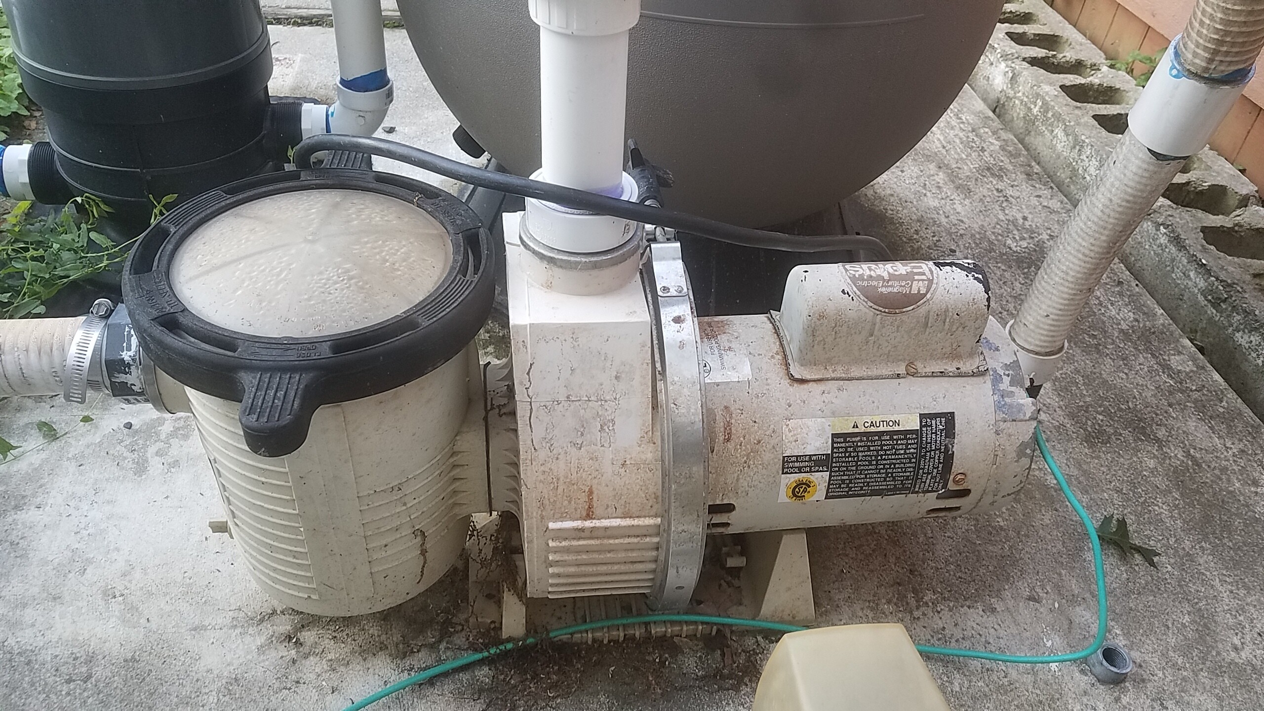

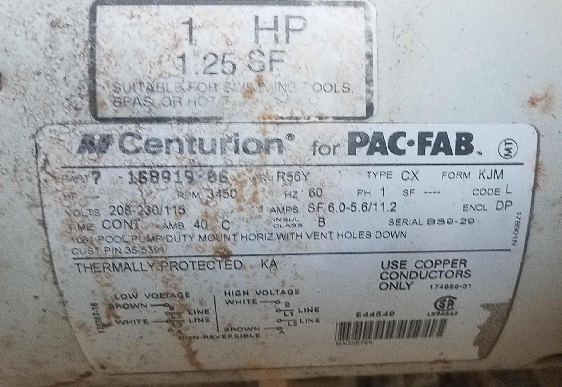

I need help to find the right replacement pump motor for my pool. Is the A.O. Smith 1 HP Motor EE - Full Rate (B2841, B2841V1) will work? The current failed motor is Centurion 1HP R56Y. Please see attached pictures.

Thank you for contacting Inyo. You have an uprated 1HP motor. The replacement would be model B2661. This is a 3/4HP full rated motor. The total HP of both motors is 1.25.
We recommend replacing the seals when you replace the motor. The seal kit is part number GOKIT20.
