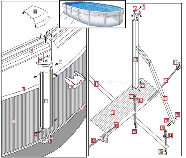

I am looking for the bottom rail of the 2009 Atlantis Pool I need 7 bottom rails but I am not sure exactly which one i need they rusted through so you can’t measure them exactly. I was looking at the replacement parts for that type of pool and the amounts of what i needed to order don’t match up with the amount of bottom rails that i currently have.

This Is the Exact pool that I have. All the peices look exactly the same.
The pool schematic you posted was the Atlantis model from before 2010. It would take the following bottom rails.
1460050 Qty 6
1460052 Qty 8
1460033 Qty 4
