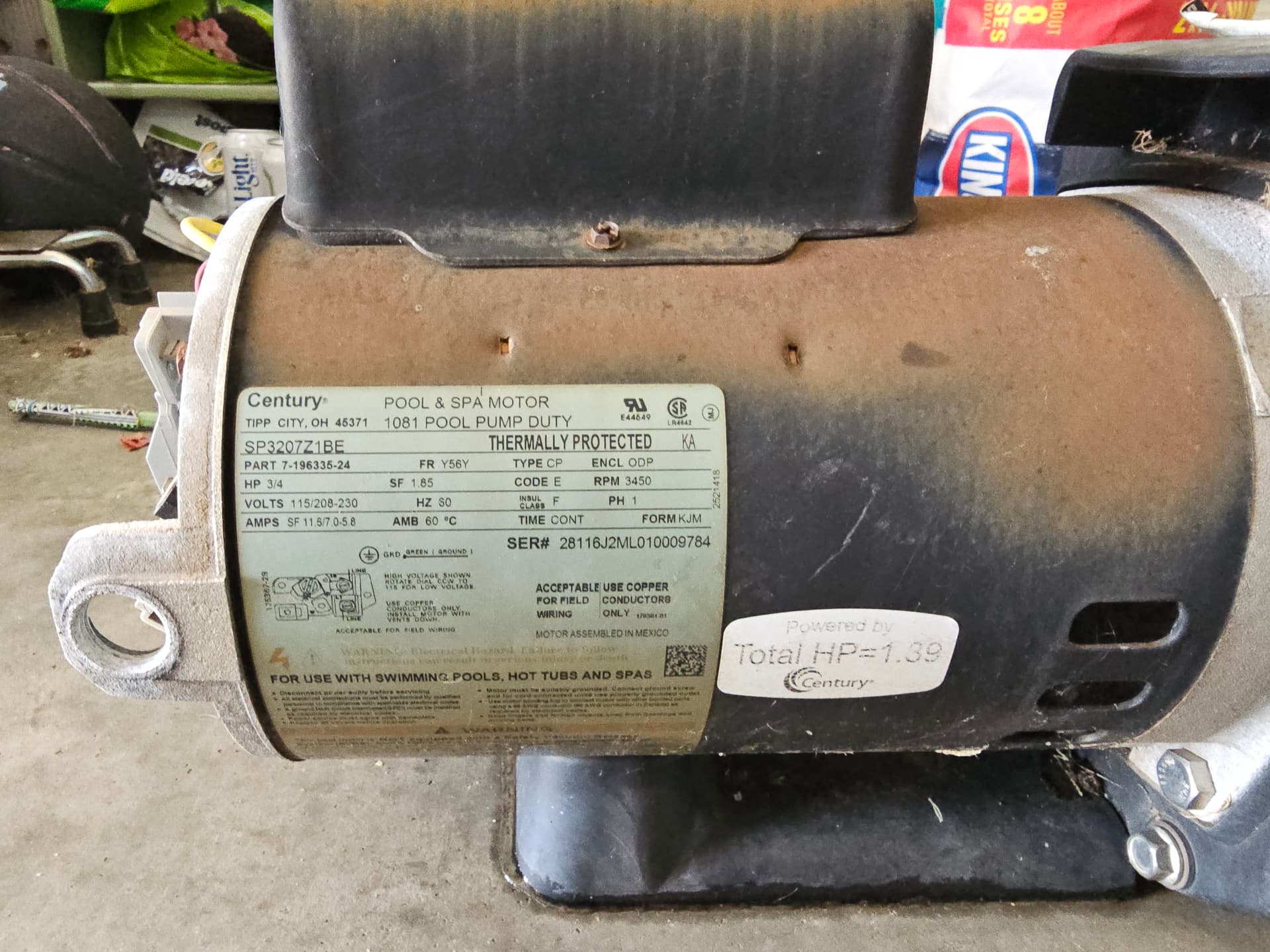

I’m looking to replace an old pool pump motor or get an equivalent motor that’ll work, below are the details.
Hayward TriStar
SP3207Z1BE
Part 7-196335-24
3/4 HP SP 1.85
Volts 113 / 208-230
Thanks,
Ron Jones

Hello Ron - The direct replacement for your SP3207Z1BE is part number 5112-252 (SPX3207Z1BER).
We recommend replacing the seals when you replace the motor. The seal kit for the Hayward TriStar is part number GOKIT81.
*It looks like you’ve already placed the order for the 1HP motor and GOKIT81. That will work as well.
