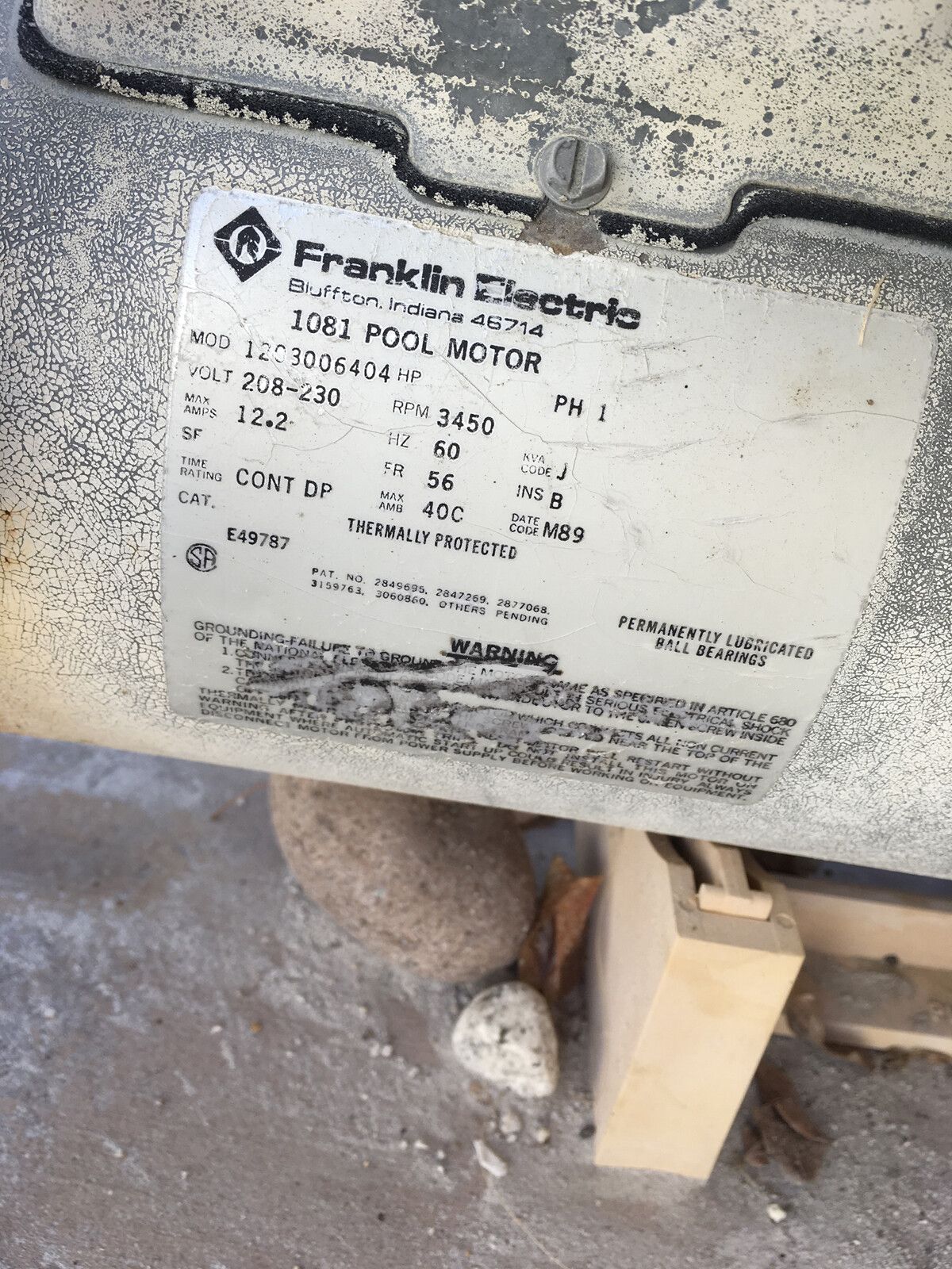

Hello Psmith - We’d be glad to assist you. Could you post a picture of the motor label?
Is this motor compatible?

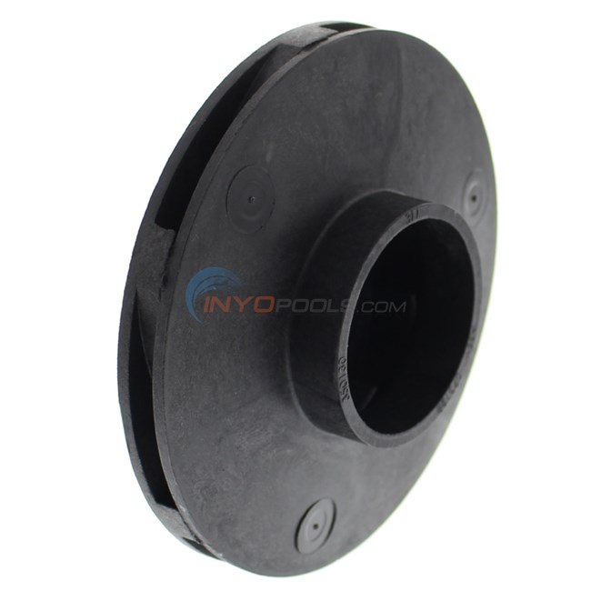

I was unable to cross reference the model numbers on your motor label. Is there any chance you could take the pump apart and get a number from the impeller? This would tell us the correct replacement motor.
This mortor is on the other jet pump. Both pumps are the same. Can you recommend a motor by this this photo.
If both pumps are the same and have the same impeller, the replacement motor would be model B748.
