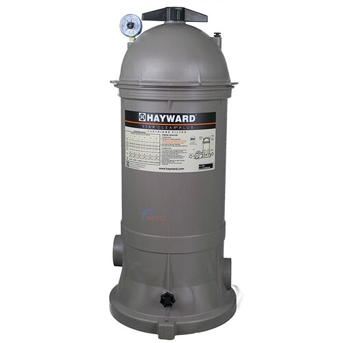

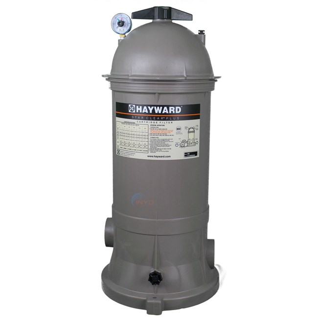

Hello Jeffrey - We’d be glad to assist you. We would recommend the 3/4HP Hayward Super Pump. The model number is SP2605X7.
The cartridge filter we recommend is the Hayward C751. This is a 75 square foot model.
