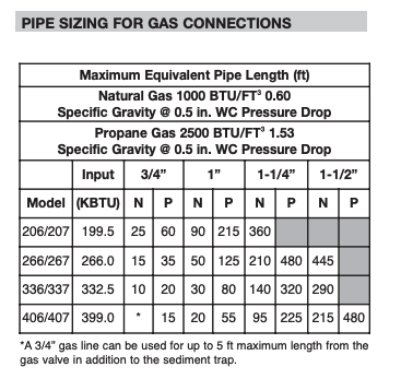

I’m sure the installer will handle this but the gas line requirements may differ between the units. Listed below are the parameters for the Raypak heaters.
Besides plumbing supplies, you shouldn’t need anything else.
