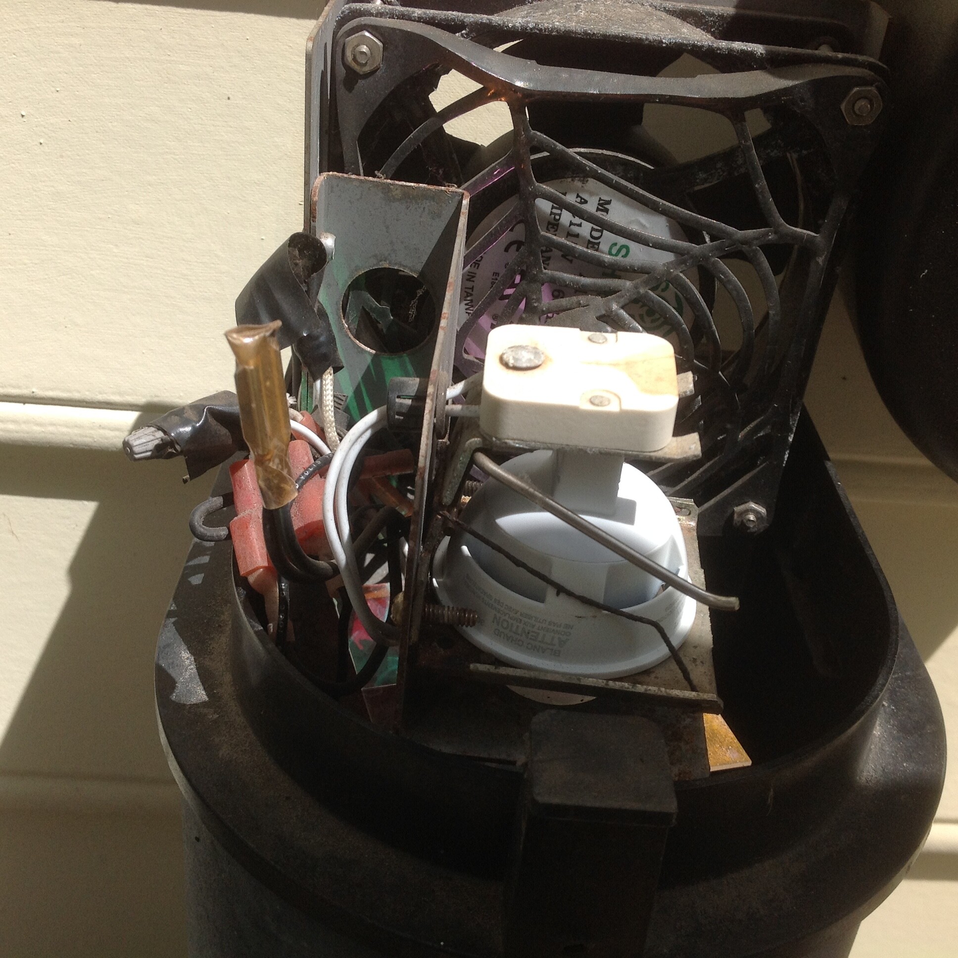

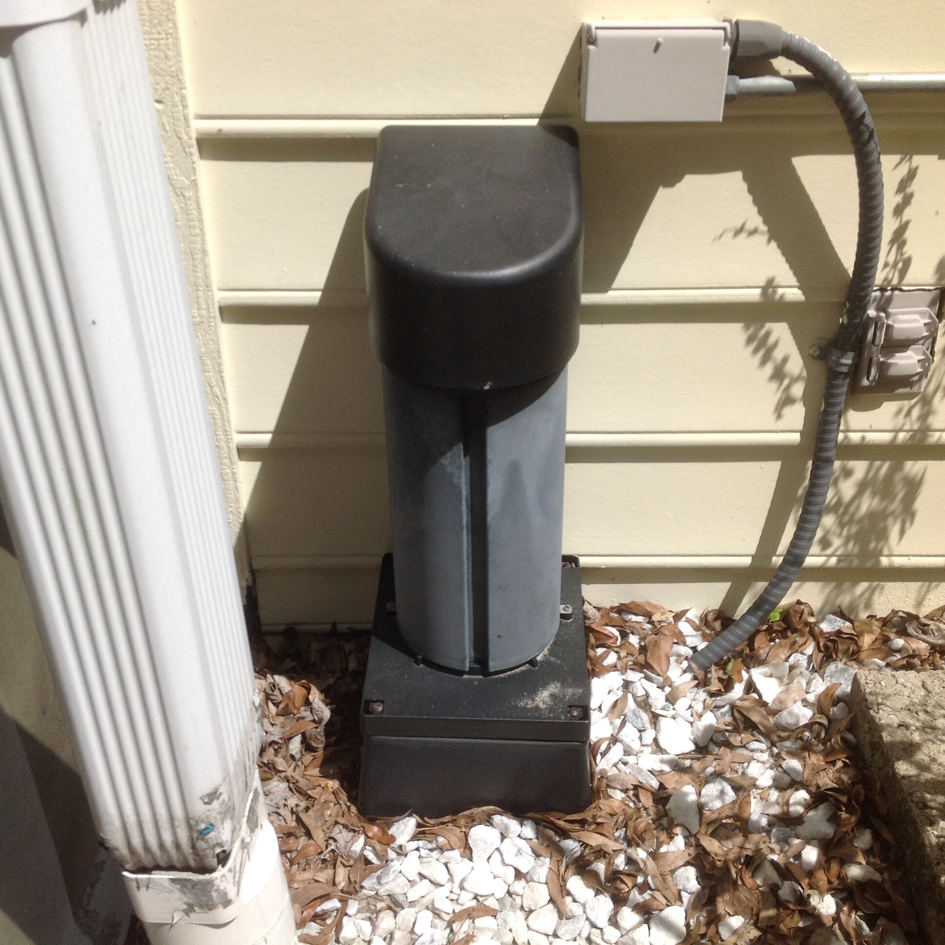

I inherited an older style fiber optic lighting system upon purchasing a home 2 years ago.  I have no owners manual and cannot locate a manufacturer or product ID.  i’ve attached a couple pictures in hopes you could help me identify the unit and possibly assist with info on replacement parts. You can see the fan guard is melted, and the bulb housing is corroded.  Please see attached pictures and thanks for any input.  The unit does work when a functioning bulb is in place, but I’m concerned about the well-worn parts and possible safety issues.

It appears to be the Super Vision model SV150TMH. You can view a schematic on our SV150TMH parts list.
