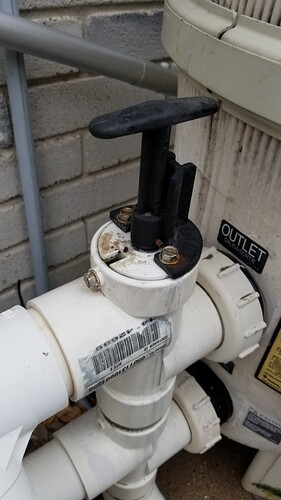

I have the Pentair 261165 valve, and I want to replace the O-rings.  Does the 4600-3054 replacement kit fit this valve?  Does the kit come with silicone lube, or do I need to order separately?  Please advise

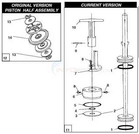

Does your piston assembly look more like the original or current version?
I will need to take it apart but was a little apprehensive because the valve will not fully seat down…I was going by the part# on the pipe.
I’d recommend going with the universal kit because it would include seals for both styles. The part number is APCK1017. Click Here to View the Pac-Fab Universal Seal Kit
