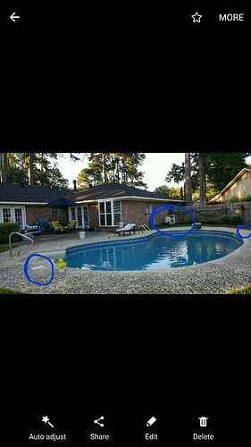

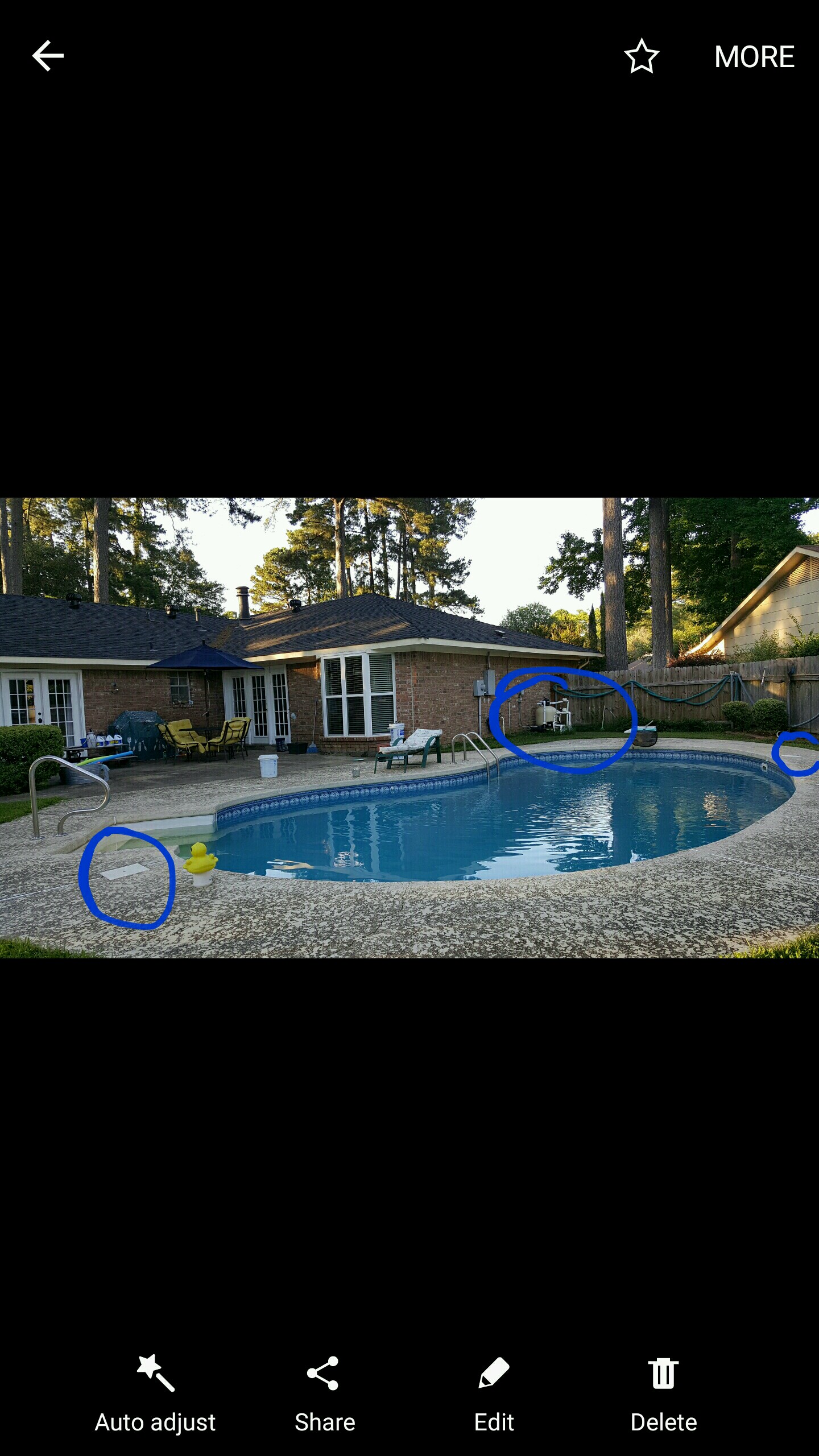

The 2 HP pump is a magnum force newer version and I’ve circled the skimmers …do not know how to figure that head whatever?
Based on this inf. what size pump should I be using?  I no longer have the old pump and cannot remember what HP it was or if I even knew and that’s why I ended up with this.  Everything is in order except the pressure …which leads me to believe the pump is too much?

Yes the 2HP Jacuzzi Magnum seems to way to big for your 12,000 gallon pool and for your TA60D sand filter. Normally you would size a pump to turn your pool over in 8 Hrs. Based on your plumbing set up the 2 HP Jacuzzi Magnum would be outputting roughly 100 Gallons Per Minute meaning that in 8 Hrs. it would be circulating 48,000 gallons or turning your pool over 4 times in 8 hours.
I would suggest the 1 HP Jacuzzi Magnum which is going to be in the range of 60 gallons per minute meaning it can turn over 28,000 gallons in 8 hrs. this is still above the 12,000 gallon mark but it is nice to have a bit of extra suction for vacuuming the pool.
The reason you were most likely seeing such a high pressure reading is that the TA60D sand filter is only designed to handle a max flow rating of 60 GPM and your pump was trying to output 100 GPM through the filter. This will cause high PSI readings, will shorten the life of your motor and potentially damage the internal components of the filter.
Another thing to consider is that your pool is plumbed in 1.5" pipe and 1.5" pipe can physically only handle 60 GPM going through it, so the larger 2 HP pump could potentially be starved for water as the 1.5" pipe cannot handle the volume of water the 2 HP pump is pumping.
