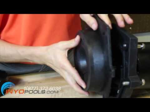

When replacing your motor we would suggest a Tune Up Kit which includes the gaskets and shaft seal for your pump and you would require this Pentair Whisperflo Tune Up Kit.
Below are two videos you may find helpful, one is on How to Replace a Pool Pump Motor and the second is How to Replace a Shaft Seal.
