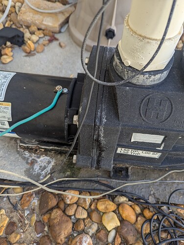

Hayward pump with a leak between the seal plate and pump. Motor side of plate seems dry. Suggestions?
It looks like it is time to replace the shaft seal on your Hayward Super II pump.
We would recommend getting a Tune-Up Kit, which will contain a new shaft seal as well as all of the other gaskets you will encounter to ensure a leak-free installation. The o-rings tend to flatten out over time and leak if they are disturbed.
