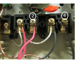

Hello Bosshog - There is only one reason, that I can think of, why the pump may be getting power when the timer is off. It’s possible that one of the lines from your pump is connected to a line terminal on the timer. If that’s the case, that line would always have power. If you have a 230v Intermatic timer, the lines from the pump should be connected to terminals 2 & 4. Terminals 2 & 4 are the load terminals.
