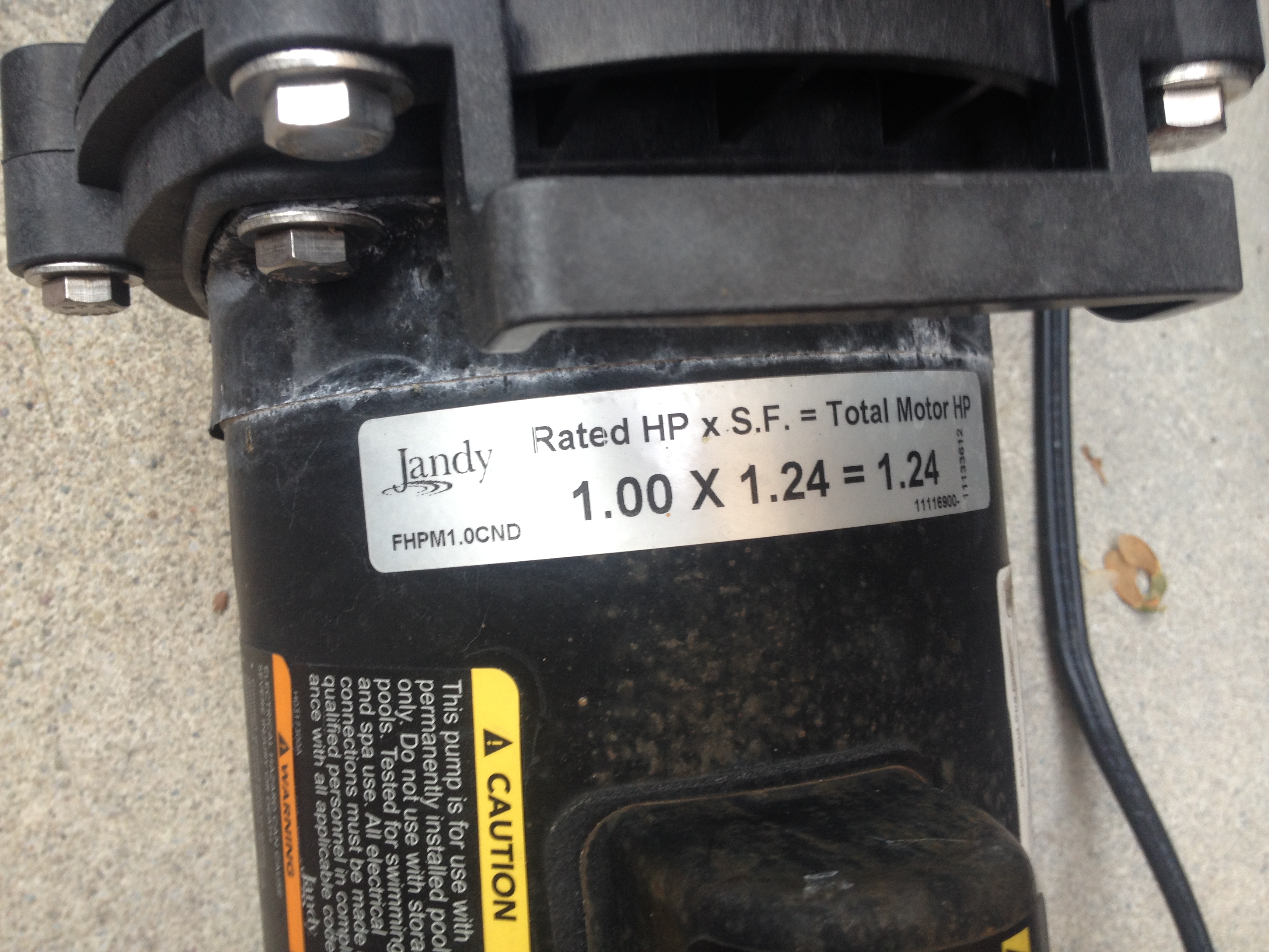

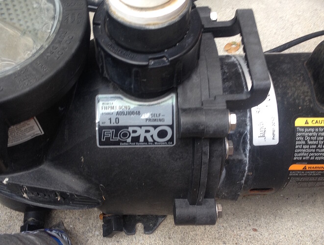

Hey Patrick - thanks for your help.
My Pump is a Jandy - photo follows.
Stan
Hi Stan,
You would require this Jandy FHPM Flo Pro Seal Assembly
