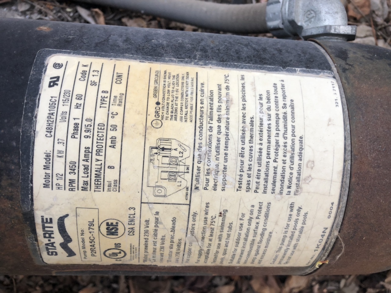

I have an old Sta Rite 1/2 HP motor that went out on my. See the attached pic. Can you tell me which motor would work to replace it? Thanks
Looks like a 48Y Frame motor.
This might be a good one
V-Green 1.65 HP Square Flange 48Y Variable Speed Motor - ECM16SQU
Or this one
Century 1/2 HP Square Flange 48Y Up Rate Motor - USQ1052
