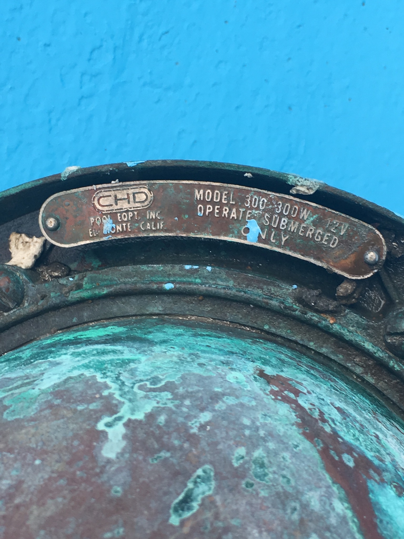

We yet to have confirmation if the PL5808 PureColors LED Bulb will fit into the old CHD light fixture. The bulb would work in the fixture its just a matter if there is enough room to accommodate the bulb. If you would like to try the bulb and if it does not fit then you can return for free (just let me know). If you just post back to this thread if it worked or not that would be great so we could update our product data to include the CHD light.
If you did want to go with a complete new fixture then the Pentair Amerlite is the replacement for the Purex CHD light and the PureColors PL5808 LED Bulb does work inside the Amerlite light fixture.

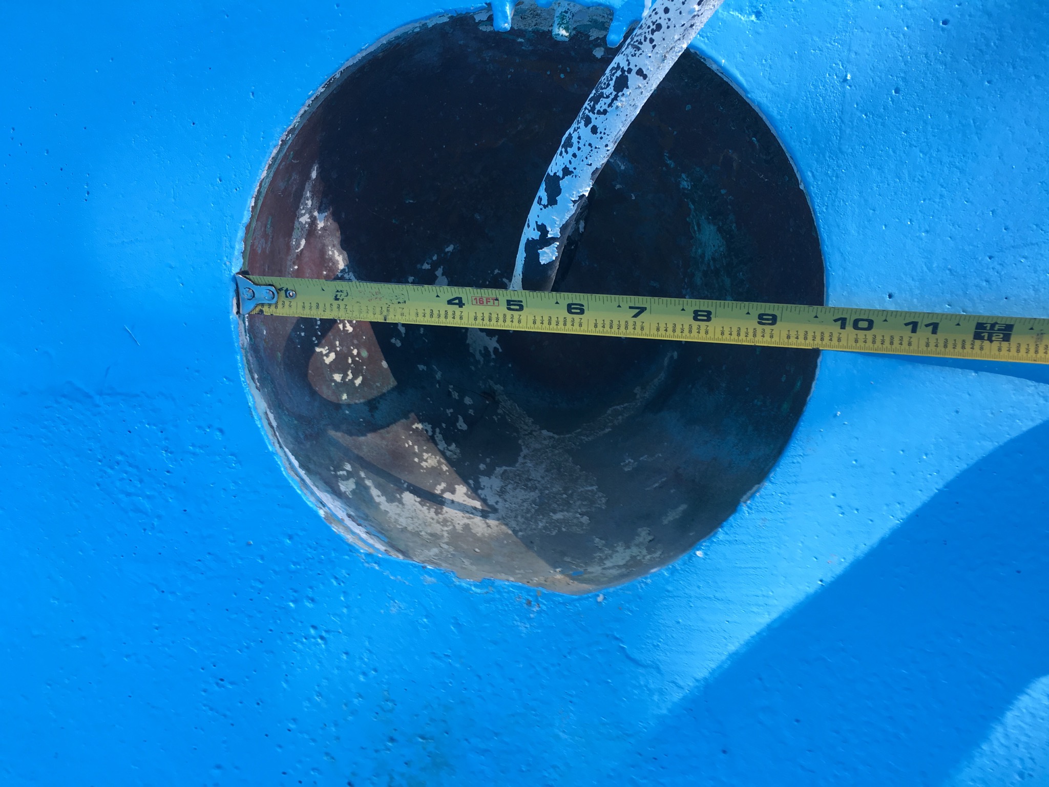

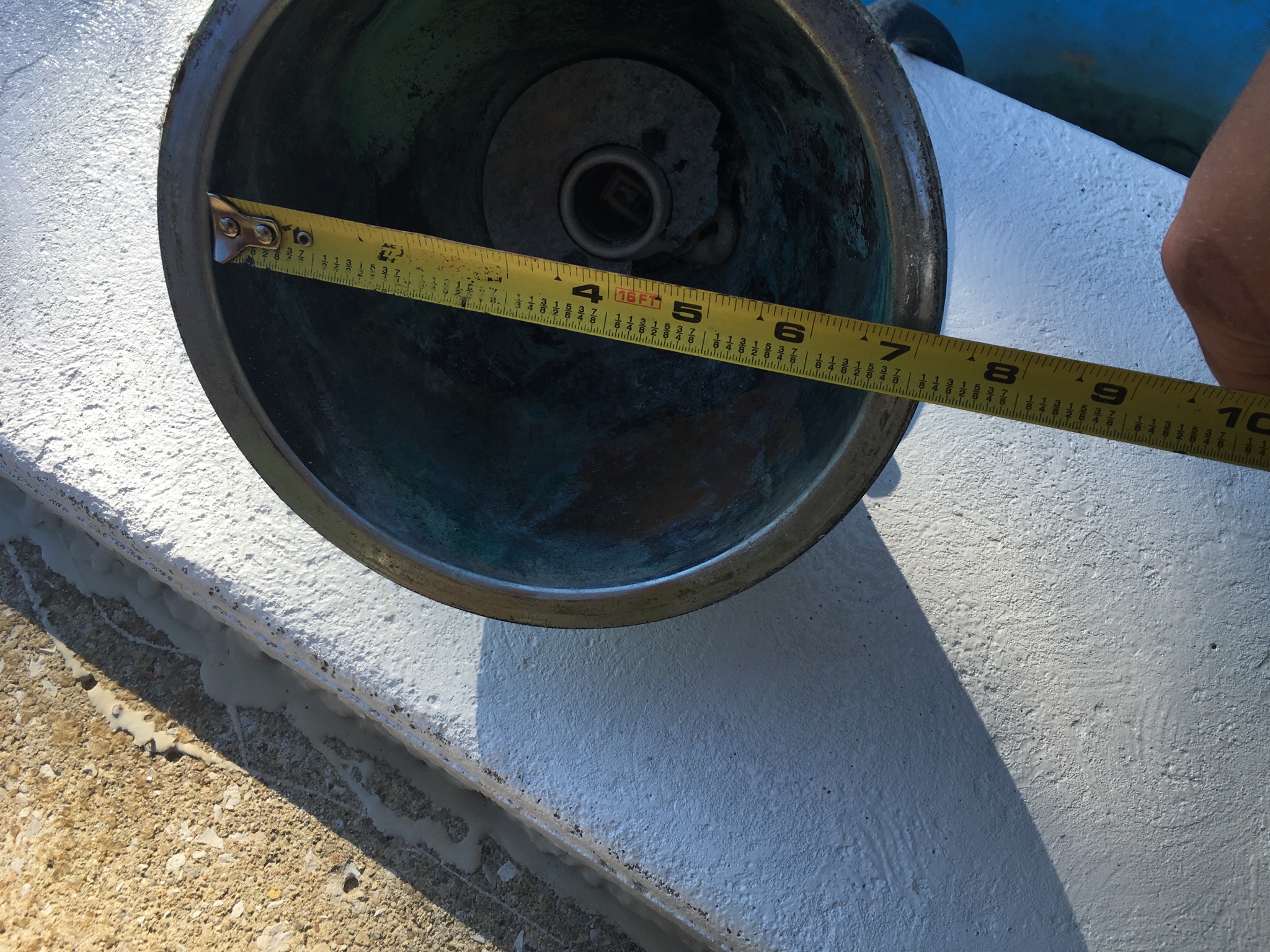

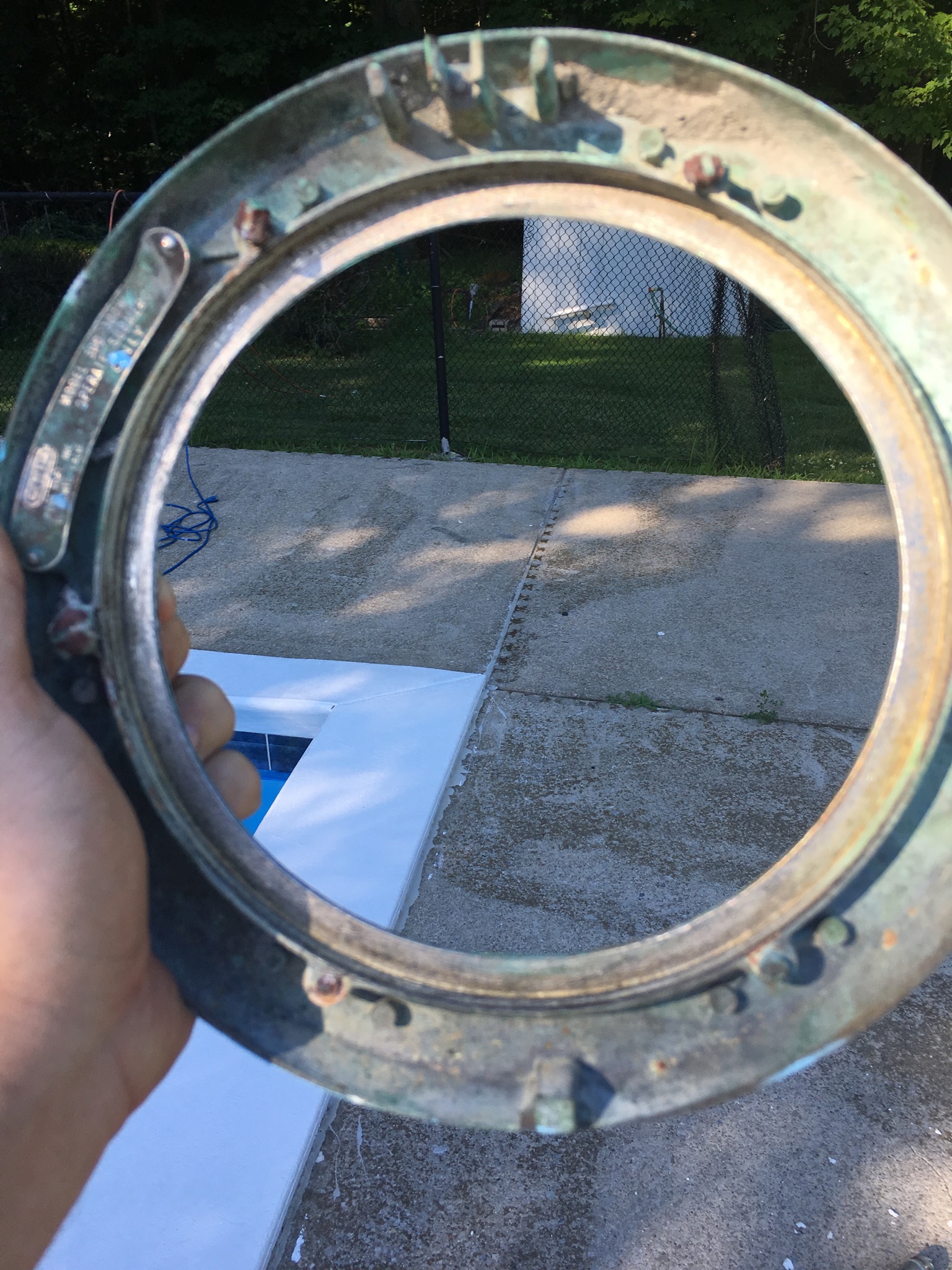

Ok thank you for that, I got the dimensions of the light and I measured the cone on our existing light and it seems like they are the exact same 6-5/8" wide, we want to get a new fixture but it seems like every light you guys sell is screwed into the wall and ours clips into the casing in the side of the pool I just wanted to know if that will be a problem with the new lights. Here are a few pictures of what I’m talking about
I actually just heard back from a customer who used this the PL5809 on this fixture and they said it worked. I think you would be fine with the PL5809 bulb and your current fixture. See comment below…
“A few months ago I asked if this bulb PL5809 would fit my Pac-Fab pool light YES it fits and works great. Thanks Dan”
Ok thank you we will give it a try
Thahnks so much, please report back on how it works.
