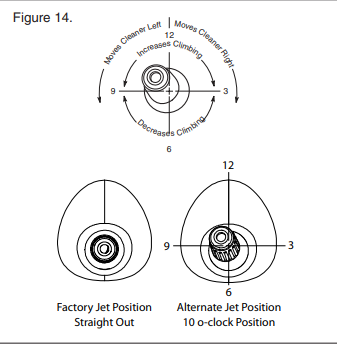

My Racer pool cleaner works, but it frequently gets stuck in the exact same spot in my pool. I noticed that the right side Turn Jet does not work. I wonder if replacing the L and R Turn Jets would solve the problem? Any comments?
Harry. You may need to adjust the thrust jet based on the pool shape, in order to get maximum cleaner coverage.
The alternate jet position shown below can help the climbing ability of the cleaner. See figure 14.
