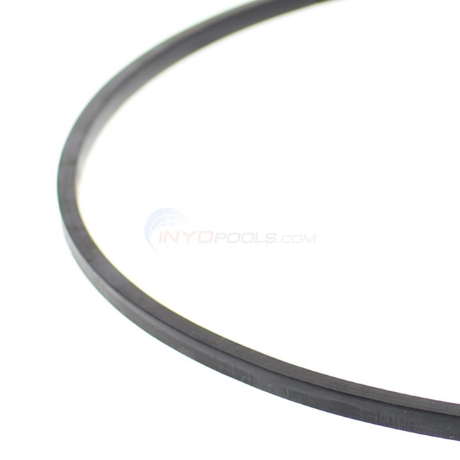

According to the owners manual that came with my Pac Fab, the O ring for the front housing is part # (35-5329). My front housing is leaking so I ordered the part from Amazon. It just arrived and it’s different. Instead of square it’s round. My question is, will it work ?
A lot of pool owners have not had success replacing the square-cut gasket with the round one. We do carry the square-shaped housing gasket. Click Here to View the Square Housing Gasket 355329
