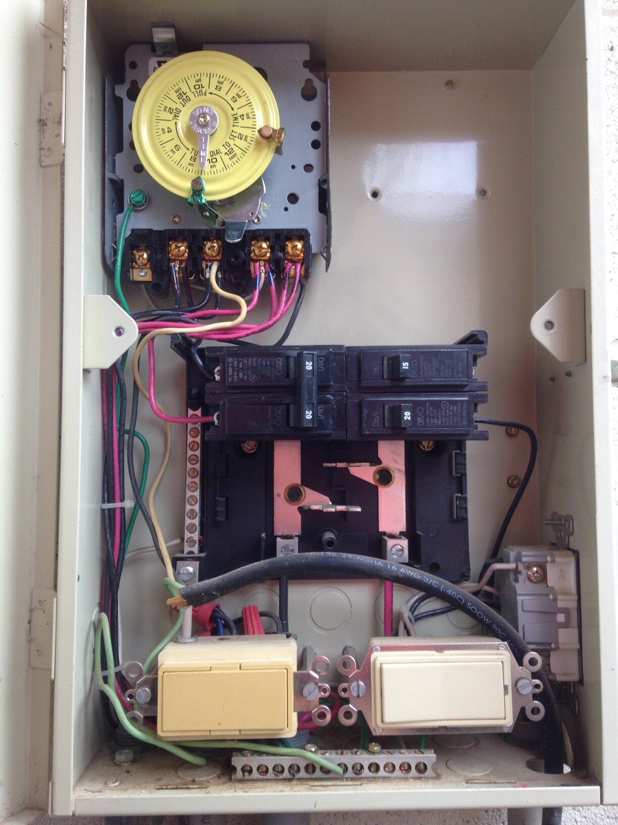

Installed new T104M intermatic workings. It turns on fine but does not trip to turn off. Do I have something installed wrong?
Hello Billyboy - We’d be glad to assist you. Do you have the tripper that says “off” installed on the yellow dial? If so, could you post a picture showing us how the cables are installed?

Here is pic of my wiring. It looks like a mess
my issue is over the timer is defective. Discovered when the off trip gets to the point it shuts off the clock face pops out a little and and it doesn’t turn it off. Amazon is replacing the timer.
