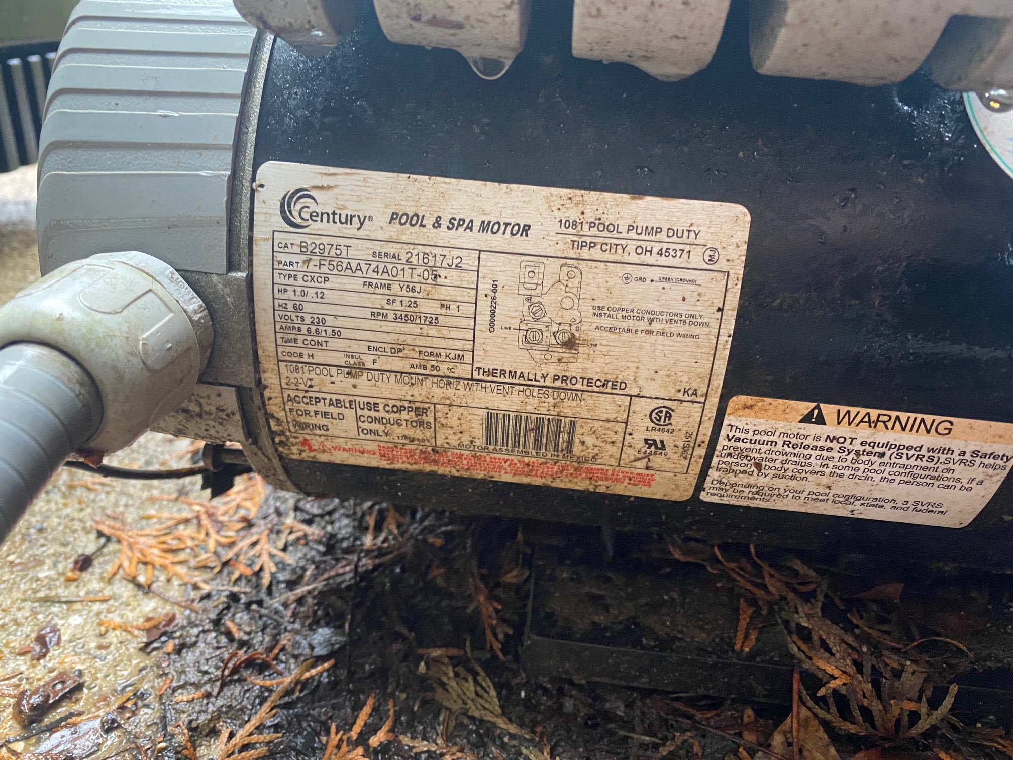

My motor went out on my pool pump. I would like to find a replacment motor that is similiar. The motor I currently have now is a dual speed motor and I would like another dual speed motor. I have a Heyward super pump, but a century motor.
Your motor with the built-in controller is no longer manufactured. The replacement would be model B2975. The B2975 does not come with a switch for the speeds. You’d have to connect it to a timer that can control two speeds or have an electrician wire in a switch for the speeds.
