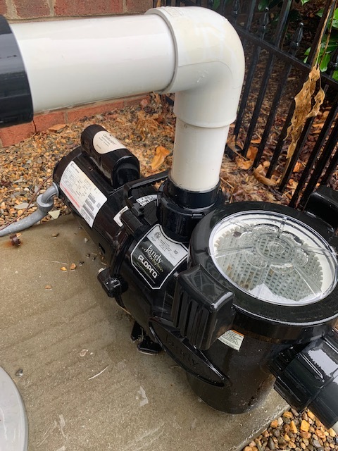

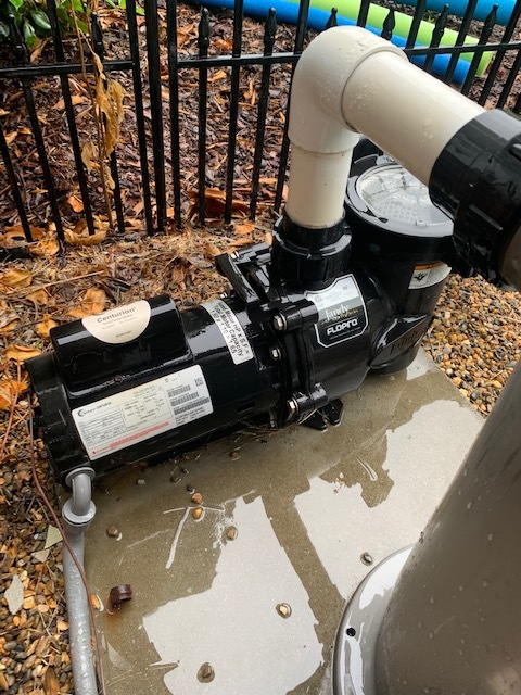

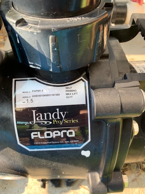

I need to replace my Centurion motor model 193986 is B2854 the correct replacement? and do I need to replace the seal kit?
motor mod# 193986
Part 7-193986-24
Frame Y56Y
volt 230/115
Amps 8.0/16.0
motor mod# 193986
Part 7-193986-24
Frame Y56Y
volt 230/115
Amps 8.0/16.0
Hi Brad,
You will require this B2854 Replacement Motor. When replacing your motor you will need a seal kit. For us to suggest the proper seal kit could you send a photo of a wide shot of your complete pool pump to show the pipes going in and out of the pump? Could you please post those photos to this forum thread. Once we get this photo we can make the proper recommendation for the seal kit.
