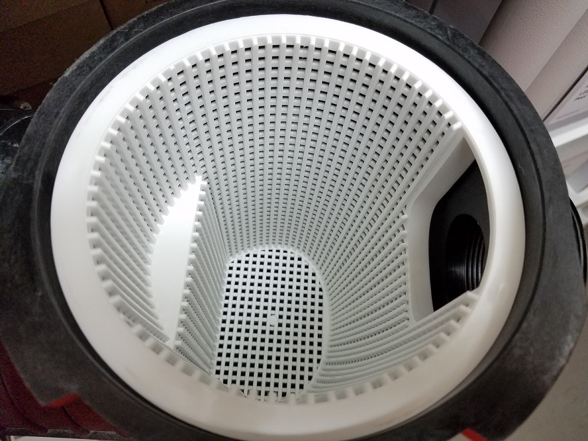

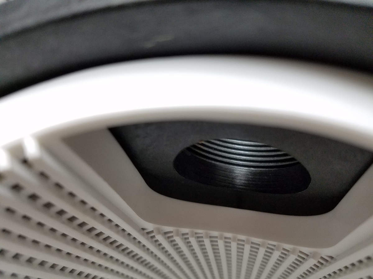

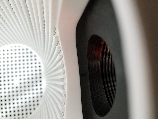

Below are pictures of the basket in the pump pot. The spacing between the basket and the intake port looks to be about 1/4". Is this the same as what you have in your strainer pot?
Yes, that’s exactly how mine is, great pictures. The basket should fit snug in the pump pot with no gaps. Leaves and debris get through that gap and make it into the impeller, and after just a few weeks the pump gets weaker and weaker, and the impeller has to be cleaned (and not just a little, but a LOT).
