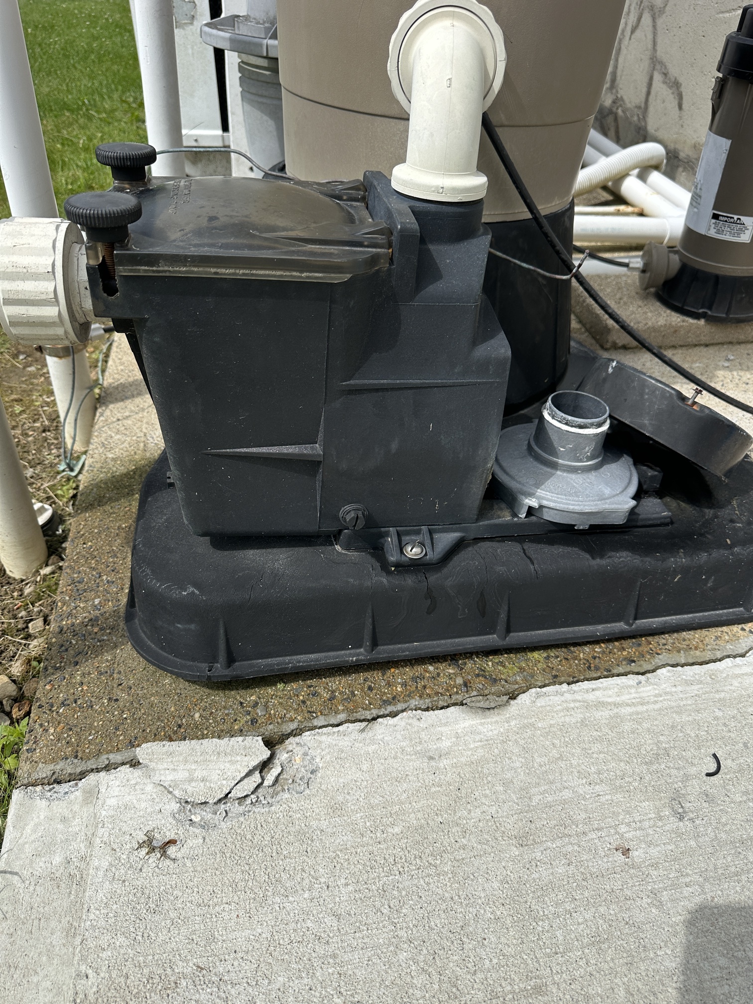

Need help identifying the proper shaft seal kit. I have a Hayward pump connected to a Century Centurion HST110 1.1 HP motor. I don’t know the exact model of the pump. Thank you.
It looks like you have a Hayward Super Pump, so the GoKit3 will have everything you will need for a leak-free installation. You may want to get the GoKit3Salt if you have a saltwater pool.
I was just able to locate a number on the underside of the basket cover and it says H – 1600 – D
Is that still the same kit?
Yes, the seals in that kit will be perfect for your pump.
