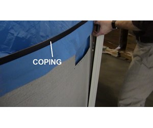

It sounds like your old liner was a beaded liner and you are replacing it with an overlap style. You’ll need to remove the bead receiver from the top of the wall. The new liner will overlap the wall and then a coping strip is used to secure the liner. Then the stabilizer is installed over the coping strip and then finally, the top rail.
The picture below shows an overlap liner secured by a coping strip.
