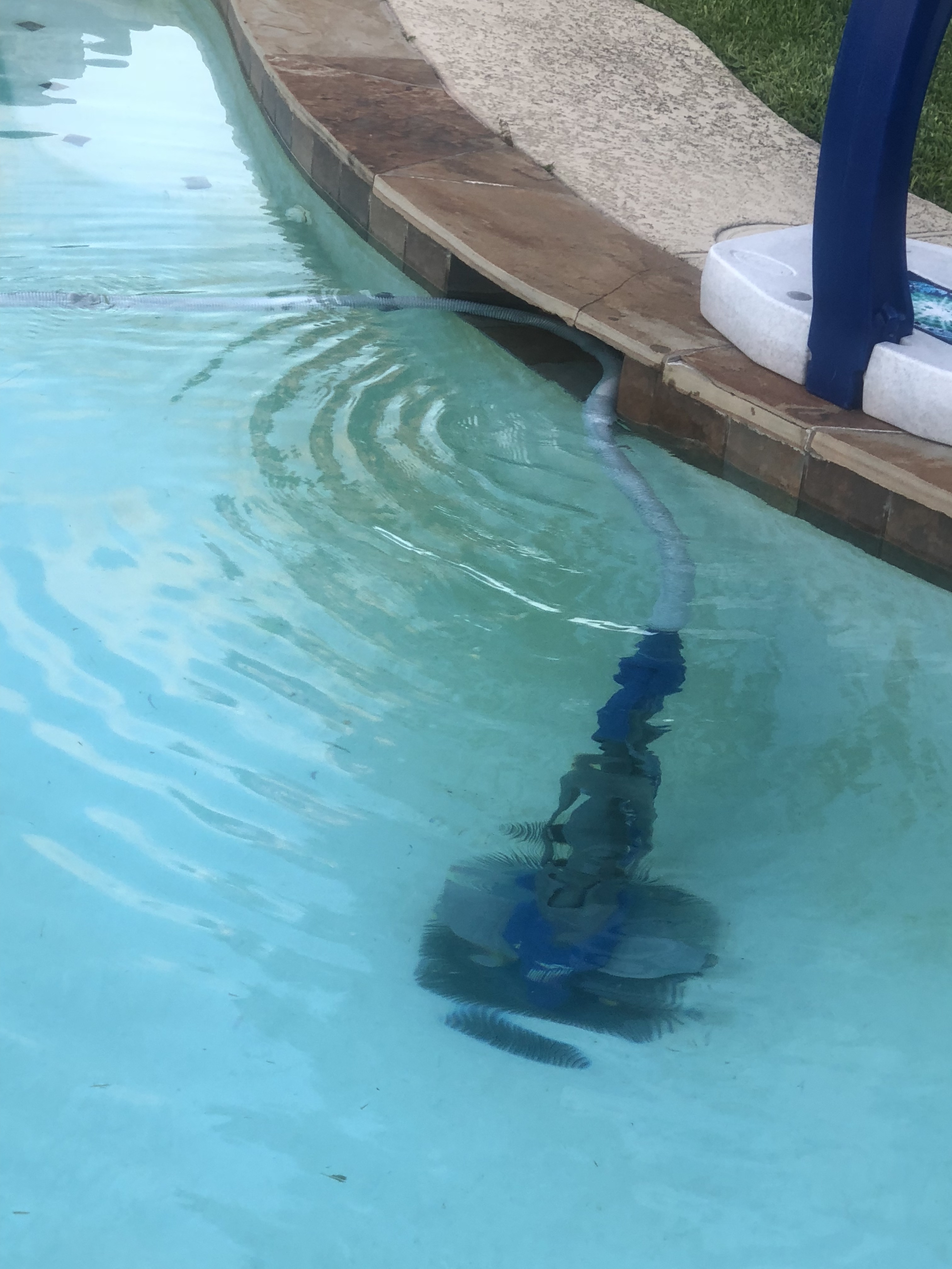

So my Kreepy Krauly hose keeps getting sucked up into my skimmer basket. Any ideas on how to keep that from happening??
Hello Roger - The water level looks a little low. The first thing I would try is adding about 3" of water so that the water level is at least halfway up the skimmer opening. Let us know if that works.
Thanks Rob. For whatever reason, that seemed to correct the issue. I might’ve forgotten about the water being on and added a bit too much, but regardless, the issue is fixed! Thanks again!
