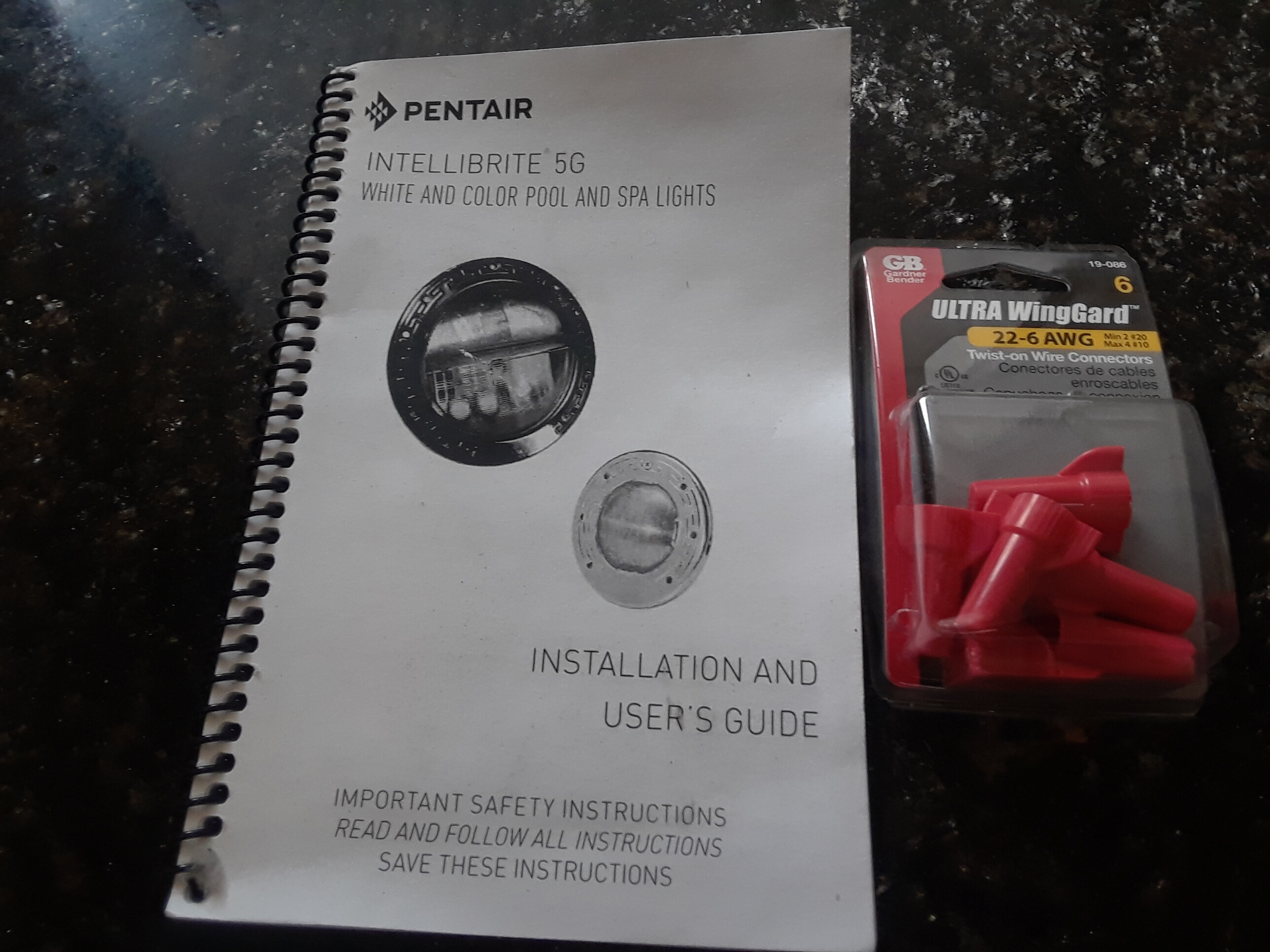

Hi, I purchased your Intellibrite 5G and ready to install it. Is it ok and safe to use Twist On Wire Connectors for the wiring or using a crimping method. Please see pict
ure attached. Thanks
Hi GeenaPower,
Twist on wire connectors back by the junction box or transformer will be fine.
