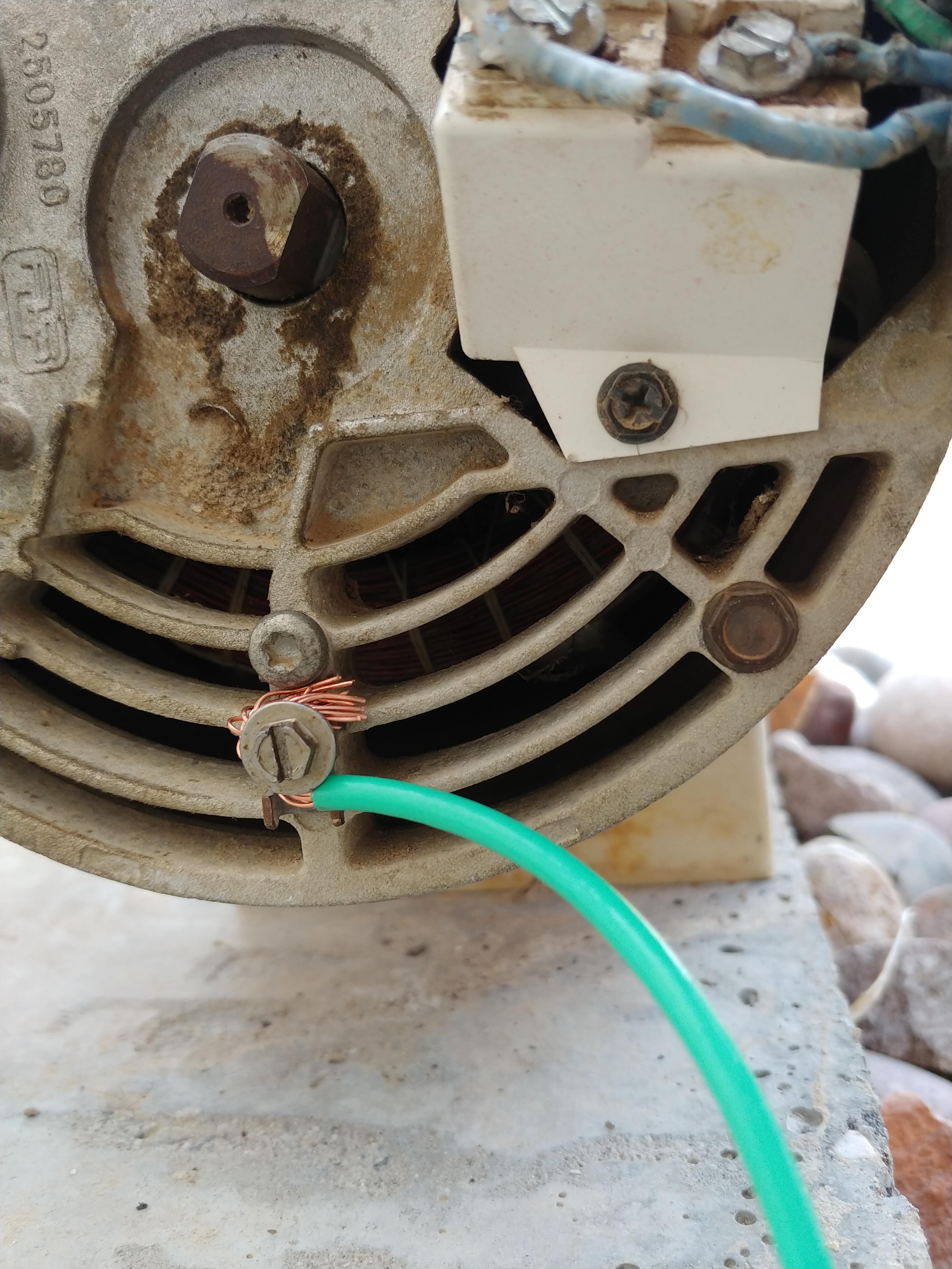

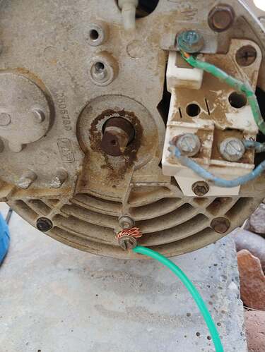

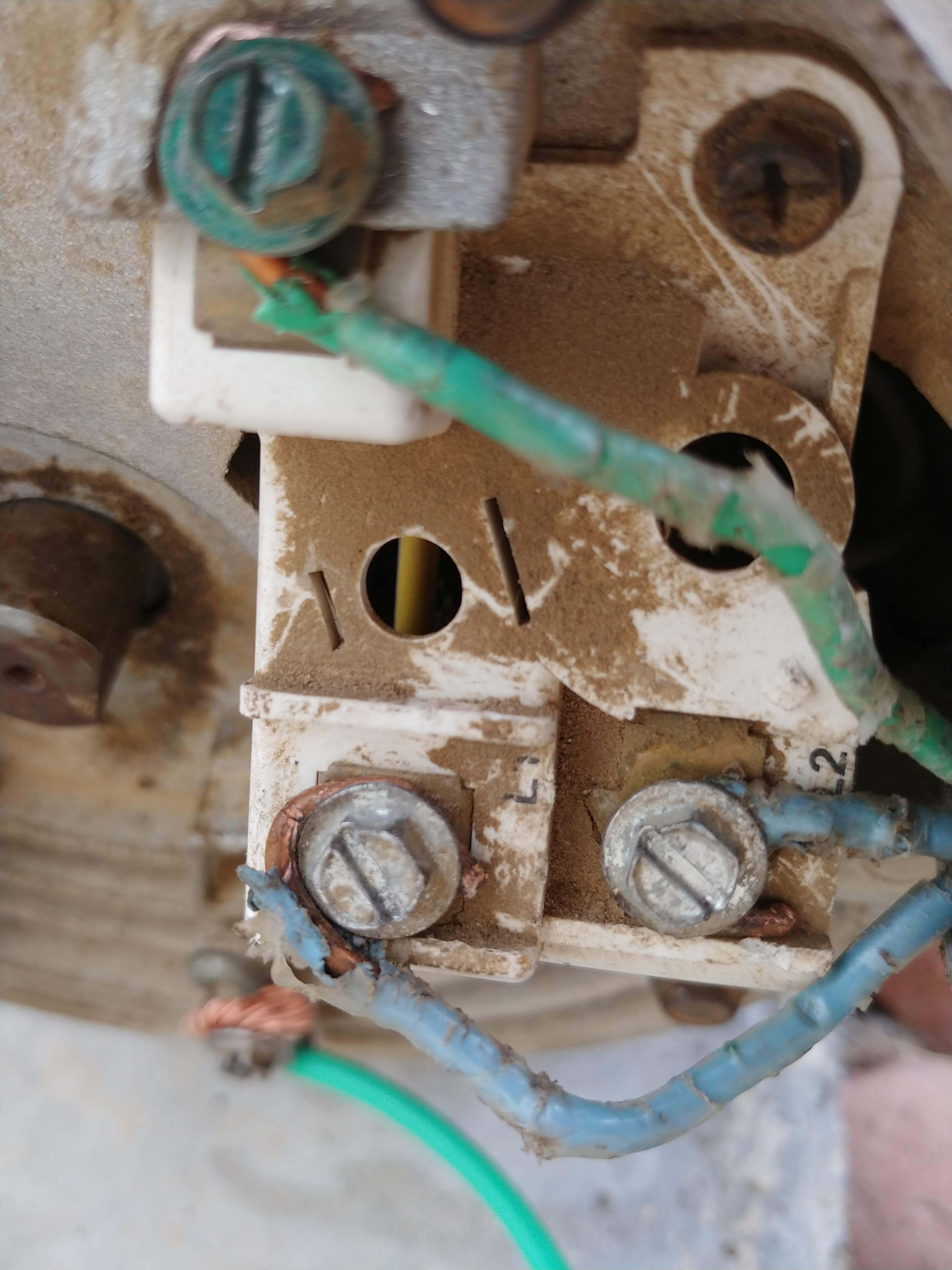

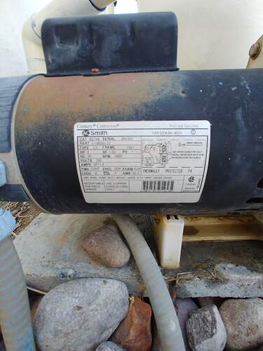

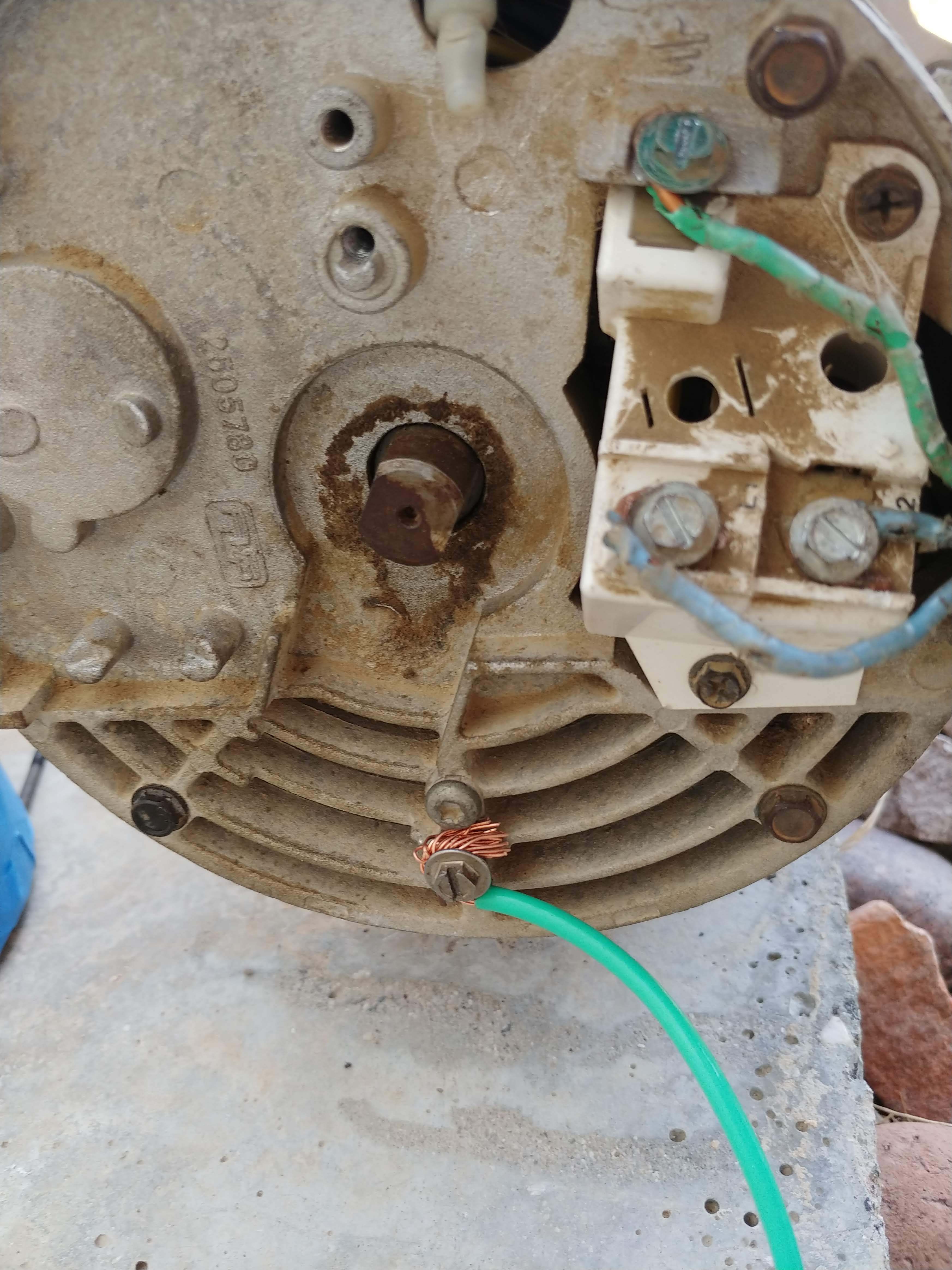

how to wire my pool pump see pics. not working in this connection
You have it wired correctly. If the motor is receiving 230v and it’s not running, it may be time to replace the motor.
