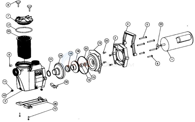

The most common items which cause leaking are the following items in the following order (items listed below). Can you confirm that you have replaced all of these parts? If so then I would take the pump back apart and inspect that each of these items is seated properly. Other things to check… is the impeller fully tightened down? Double check that the shaft seal was not installed backwards.
Shaft Seal Key #14
Housing Gasket Key #25
Impeller Ring Key #19
Diffuser Gasket #21
