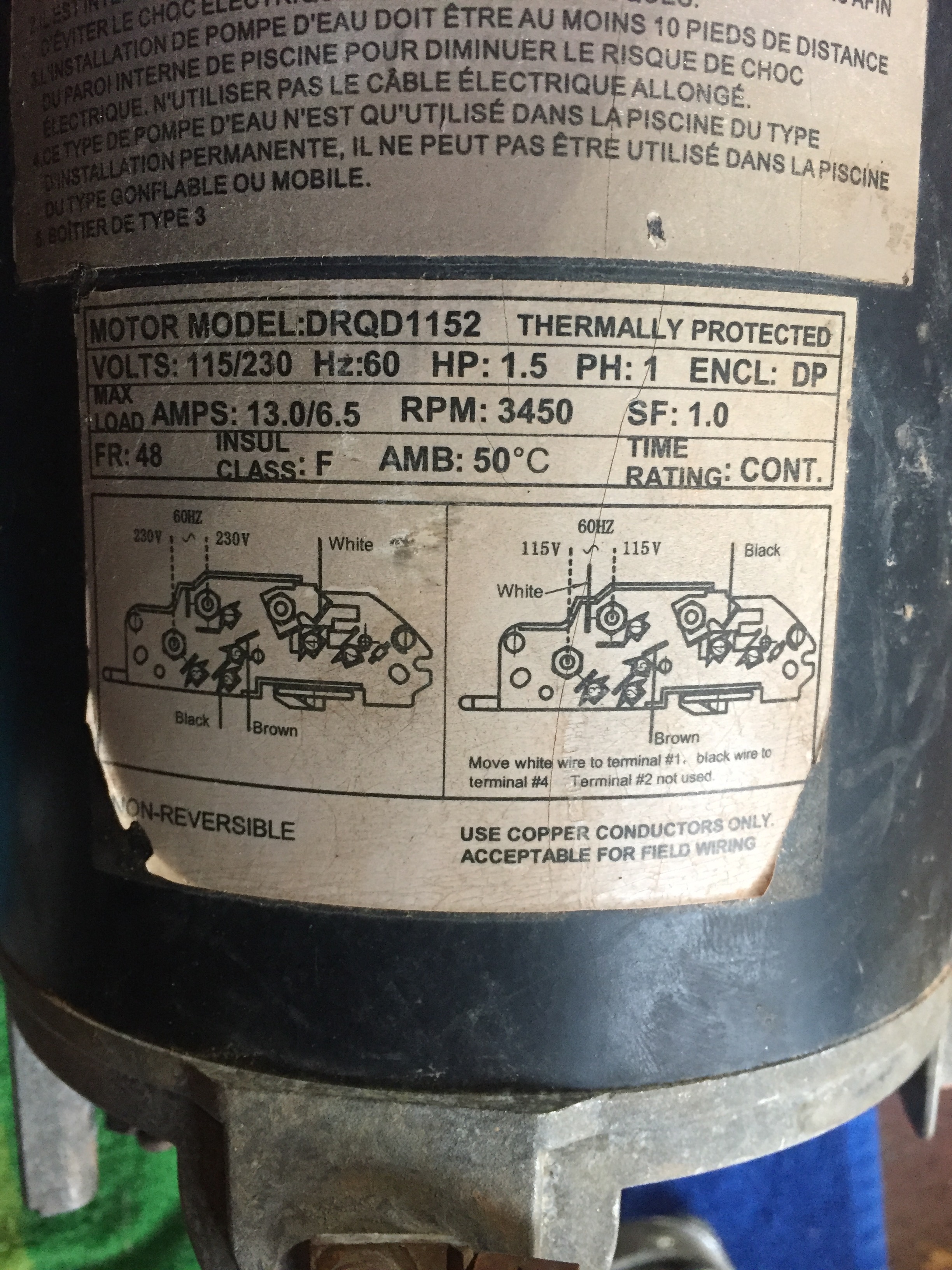

Hello John - Could you post an image of your motor label? If not, what is the frame type and service factor?
This is the motor I’d like to replace with a more economical one.
Thanks,
John
Hello John - Our replacement for the DRQD1152 is part number PL1135. Unfortunately, the PL1135 is not more energy efficient. It is less efficient than your current motor. We do not have any other options for that particular pump motor.
