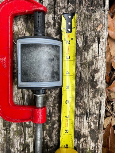

Lookin for this particular diverter valve. I include the pictures with dimension for the total height so that it will fit into the existing housing. I have more pictures with dimension if needed.
Thanks for the photo! You will require this Hayward Diverter Replacement which we do currently have in stock!
Thank you, but I think I have the wrong brand in the original post. It’s a Pentair part (not Hayward). Will the one you shown still work for Pentair housing. The bottom post on the the Pentair is tappered versus sharp/swquare edge you shown. I think th epart number for Pentair is 270075, but I am not certain.

Yes we are showing the Pentair 270075 is the correct replacement however we are out of stock on that part. We have another company that makes diverters for various valves and we have put an email in to them to see if their diverter will work on a Pentair diverter valve, as soon as we hear back from them we will let you know.
Thank you very much!
You’re welcome! Unfortunately, the CMP diverter I was looking into will not work. Since the Pentair diverter is out of stock you may want to consider a completely new Diverter Valve as the price of the complete valve is not that much more expensive.
Below are a few links to Diverter Valves we have in stock. Also please confirm that your valve is 1-1/2" x 2" (meaning 1-1/2" pipe goes on the inside and 2" goes on the outside) the other options is 2" x 2-1/2" (meaning 2" pipe goes on the inside and 2-1/2" goes on the outside). I was also not sure if you needed a 2 port or 3 port valve so I have listed all options below.
