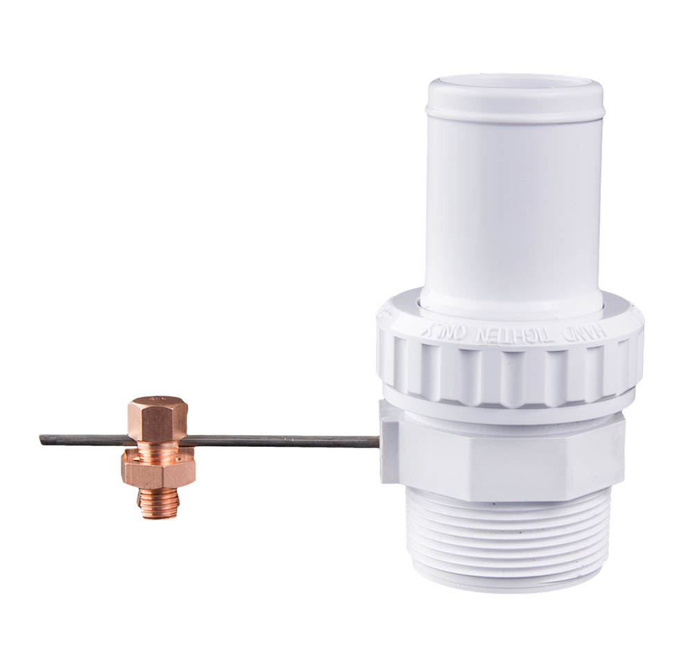

https://www.c-m-p.com/cmp/wp-content/uploads/2014/08/25810-850-000-econ-union-with-bond-catalog.jpg
looking for a Union water bond, we are trying to ground the pool water. we were told there is something we can connect the water hose to run the bonding wire to. can you help me???
