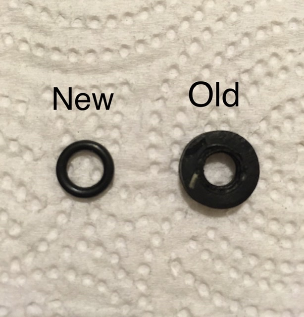

  1. The Go-kit 32-12 seems to come with more o-rings than needed for a single project, is this correct? I’m using 1 seal plate o-ring, 1 lid o-ring, 1 diffuser o-ring, and possibly the impeller o-ring (see question 2). This leaves me with unused o-rings. Is this correct?
  2. Regarding the impeller o-ring. The old impeller had a fatter, squared off o-ring/gasket that fits snugly into the recess at the screw hole (see photos). The impeller o-ring that came with the go-kit is much thinner and does not fill out that recessed area. The largest step/recessed area on the new impeller is the same as the old one, but also has an additional “step” in that recessed area, down to the brass threads (see photos). The old o-ring fits the new impeller recess, but there is still that extra small “step” recess below that before the threading. Do I use the thinner o-ring that came with the go-kit, or do I need to use the old one/replace it with a fresh matching one that didn’t come with the go-kit, or what? The smaller one is slightly too large of a diameter to fit in that small additional step.

  1. Yes, there are extra seals included because Pentair has made changes throughout the years and the kit is made to cover all versions.
  2. You can use either one. That impeller screw and o-ring are not essential. https://www.inyopools.com/Blog/do-i-need-an-impeller-lock-screw/
