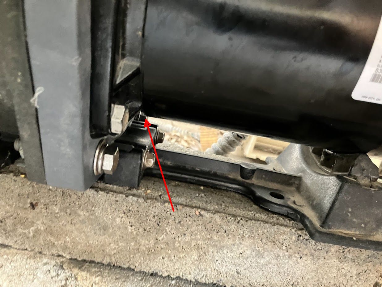

Thank you for helping. The leaking is at the bottom, between the pump and the face plate. The water is on the pump side. Very slow (1 drop every 40 seconds). I will get pictures later (on a biz trip).

[edit, replying to previous request]
Picture attached. Red arrow is where I see water drops.
Yes, that is most likely leaking from the shaft seal. Let us know if you have any issues after installing the new one!
Will do. Thank you so much!
Got the new shaft seal! Redo the assembly. Overnight, it is as dry as bone. I will keep checking it for a while. I think it has been fixed. Thank you a zillion!!
