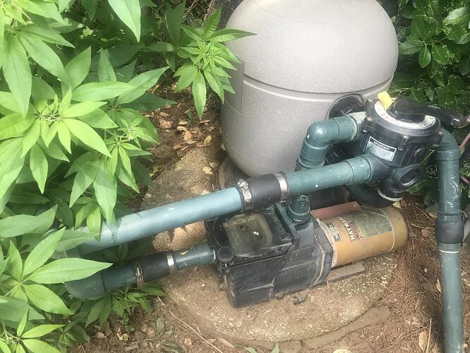

Hello,
I recently purchased a replacement motor from you for my 1HP Hayward Super Pump, since I’m at
I am going to replace everything, ie: impeller, diffuser, and gaskets.

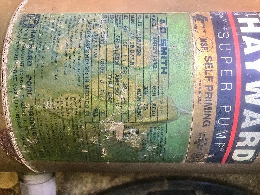

However, the nameplate /tag is totally worn off. I’m not sure which replacement parts diffuser, etc for my pump. Most are standard, except the impeller and diffuser.
Hi Sparky,
For us to suggest the proper parts could you send a photo of a wide shot of your complete pool pump to show the pipes going in and out of the pump? As well as close-up shot of the motor label showing the amps, HP, SF, Volts, etc… Once we get this photo we can make the proper recommendation for the parts.
I Hope this helps. The motor was bought between 1999 - 2002, my best guess. Thanks, Sparky
Thanks Sparky! You will require this 1 HP Hydraulic Kit for Hayward Super Pumps.
